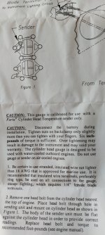

Thanks for the reply. I really don't see anywhere higher or another location to mount it. There's not much surface area near the head bolts.
Is it acceptable to mount it on the side of the cylinder instead of the head?
The instructions say to use a head bolt for mounting, but the picture really seems to show the water cover.
In Figure 1, it looks to me like it's showing the water cover.IMG_20220718_185450.jpg

Wherever you put it, it will display the temp at that location. That's why I try to put them at the hottest location. But in all reality and practicality, if you put it somewhere else and get a feel for what's "normal" for that location, you will still be able to detect what is not "normal". Heck, put it at a convenient spot and give it a try. You can always re-locate it.
