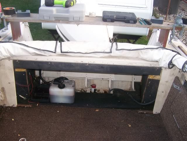

Does it look like this? Mine has oil in it that is red.But as far as i know its the oil injected resevoir.

It looks EXACTLY like that. The cap says "oil" on it. I have no trim tabs nor has there been any trim tabs on it. I'm going to put some on it when $$ allows because I have no trim/tilt on my outboard ('74 85 hp 'Rude). It's all manual tilt. By the way Fish n Gear....I browsed thru your "restoration" album last night....lots of work but looks like u have a GREAT foundation to start with. "thanks dad" is right on the $$$. I got my Starcraft for free from a local boatyard that apparently couldn't sell it since it needs work and there was no motor or trailer. I had a 17' open bow Steury collecting dust that I had purchased a trailer for but lost interest in it cause when I bought my house it was abandoned there and once I got it restored enuf to fish in, I found I couldn't register it w/out checking with the previous owner and either retrieving title for it OR getting a notarized letter from him/her releasing their interest in it. This Starcraft came around and I wanted it...mostly due to different style and....lol...."title in hand". I don't know if u've seen pics of it or not but that is my winter project. So anyway....yes my oil tank looks just like that. Thanks for replying. Good luck with ur projoect.
