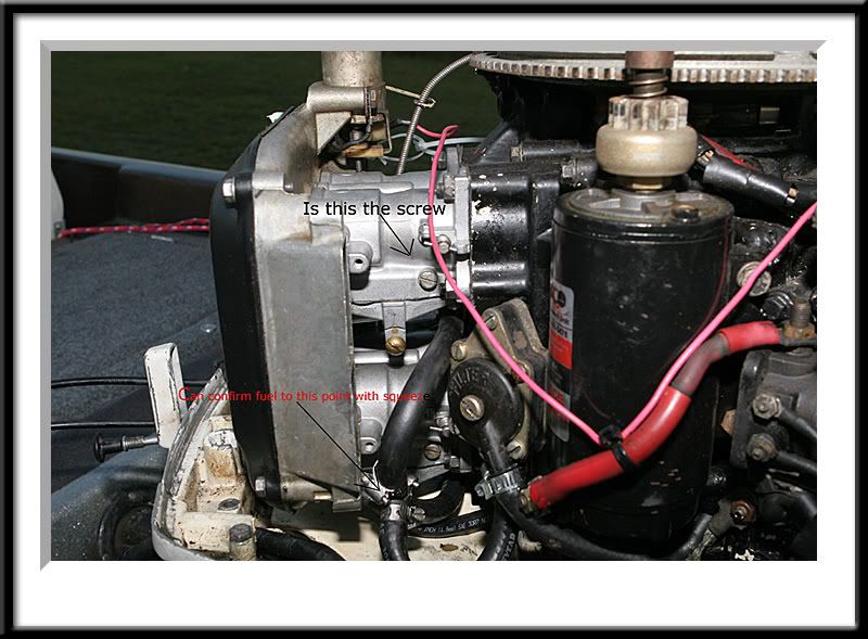

The plugs appear to be a oily black... I tried the boats onboard fuel tank and a seperate fuel tank.. The carbs were replaced in the early spring as I am told... (its the newest looking thing on the motor; except for the starter)Also, how can I see if I am actually getting fuel in the carbs?
jimmbo
May 24, 2004
14,687
Re: Ok back with some info on my 79 85hp
You could try draining the carbs. Every carb has screw or hex head screw covering the access to the main jet. It is usually at the side of the fuel bowl near the bottom. Once you drain it squeeze the primer bulb till morte fuel comes running out.
emdsapmgr
Dec 9, 2005
11,551
Jimmbo's got a good suggestion. If it only fires when you spray fuel into the carbs, you have a fuel delivery issue. You can also keep squeezing the fuel hose primer bulb-this will force fuel around the pump into the carb bowls. The blacked plugs could be from running cold-thermostats might be stuck open.

I have only checked the fuel system up to the filter/pump and up to the tee. the screen had a little particulate debris... I cleaned that and while it was off gave the bulb a squeeze.. I get fuel to that point... I replaced the filter cover and give the bulb a squeeze and it gets rock hard. Pulled the fuel line from bottom of the tee. Gave it a squeeze, positve fuel to the tee. Reconnected squeeze rock hard.
Removed the screw that I believe from the previous poster.. No fuel came out and still could not squeeze.. Rock hard..

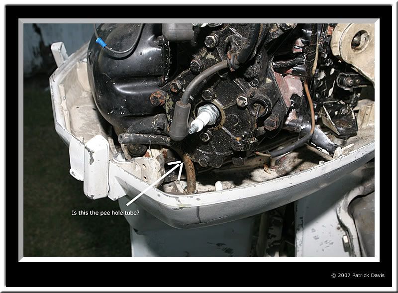

Also, I have an image of what I believe to be the pee tube. Yet its disconnected and I don't see where it goes!!!! My manual still hasn't arrived yet..

HighTrim
Jun 21, 2007
10,486
That is your tell tale tube. It should run to a little plastic white elbow coming off the rear of the motor, then to the nipple at the base of the cowl. Make sure that the nipple isnt clogged with debris or spider webs.
mdmedicgod
Aug 13, 2007
25
I can't find an elbow anywhere back there
HighTrim
Jun 21, 2007
10,486
any type of fitting that the hose would reach?
mdmedicgod
Aug 13, 2007
25
thats the strange part.... I have looked all around the length of hose in both directions.. No obvious place for it to go...
jtexas
Oct 13, 2003
8,646
the screw you have marked in the photo - that's on the carb body...you need to remove the drain plug from the bowl below.
iwombat
Jul 12, 2006
3,767
Look at the base of the bubble back exhaust cover. If there's no fitting there, someone probably replaced it with an earlier cover.
emdsapmgr
Dec 9, 2005
11,551
Somethings amiss here. A 79 85 hp does not have a bubble back exhaust. Any possibility that this is a replacement powerhead? I don't see the coil supports on the heads. This may be an older 135 block, since there is no water telltale. Are there any stamped markings on the core plug on the top of one of the heads to help identify this block? The drain screw jtexas is referring to is the brass-looking one, just below the other one you refer to.. Unscrew it. This should drain the carb bowl at that point. Prime the fuel bulb, and fuel should come out in pulses identical to your squeezing. If you get no fuel out, your carbs are candidates for removal/teardown and overhaul.
mdmedicgod
Aug 13, 2007
25
I got no fuel out of the brass screw either.. As far as the stamping on the block.. I will check when the suns comes up...
