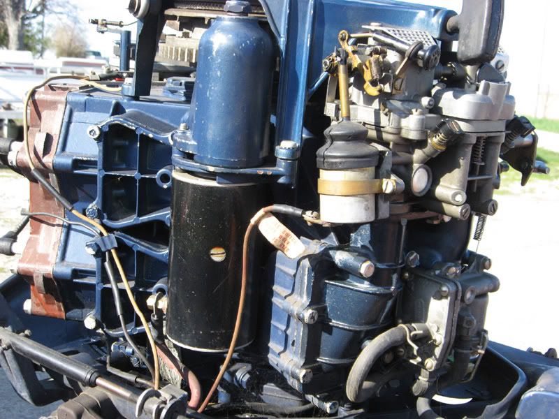

Joe,
Not to steal the thread, but I wish you were closer so you could take a good look at my '58 Four Fifty. As you can see, mine doesn't have the dump hose at the bottom of the intake manifold, and when it runs, there is no sign whatsoever of fuel dumping in the water. It idles fine and doesn't load up. There seems to be a fitting at the bottom of the intake but nothing is attached to it.
Do you think this is a '58 carb or a later one that doesn't have the "pooling" problem?

Re: Old Evenrude four fifty four
Joe, Would you mind answering my question about my carb on my '58 four fifty? I'm getting the feeling that people think "W Guy" means "wise guy" and I'm not getting much in the way of replies. Actually the "W" refers to my old car hobby. I'm a collector and historian of the early '58-'65 Chevy 348-409 motors, which were known as "W" motors.
Thanks:):)
W_Guy
Apr 12, 2009
132
Thanks Joe. I just noticed the PM. As for the "dump hose", it's been posted here that the motor should have one running alongside the starboard side of the powerhead, but my motor doesn't have one. My motor also doesn't "dump" any fuel overboard, so I thought maybe it was modified somehow. I'm in the happy position of trying to find out why I don't have a problem rather than trying to fix a problem.:):)
If you don't have a drain hose, what did you do with it???
