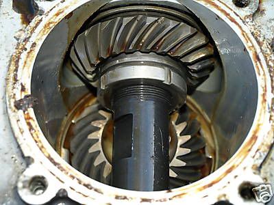

Is this what the upper gear case looks like on yours?
I think the 1986 to 1993 were about the same..

That is exactly what it looks like.....
That is correct, there was no oil sitting in the cavity when I dissassembled it.
