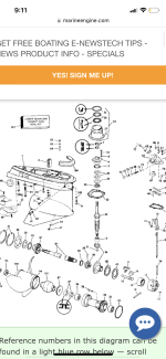

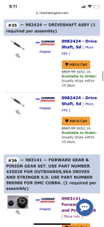

Here are photos of the diagram and drive shaft and bearing parts. 35&36.

The parts diagram lists the forward gear, reverse gear and pinion gear.
I’m guessing the pinion gear is on the lower driveshaft.
Maybe the forward and reverse gears are ok because the prop still rotates in either direction when put into to gear and the drive shaft has all the play and is the shaft that spins oddly?
The shifter dog clutch is also listed, but if that was bad, it wouldn’t go into gear right?
I am going to try to remove the lower drive internal parts tomorrow, but just trying to gather a list of parts I’ll need.

I see the nut for the shaft on the diagram. Part 31.
It looks like the prop shaft has 2 c clips holding it in. Once those 2 c clips are removed, the prop shaft slides out and I can stick a wrench into the drive to remove the pinion gear nut. Correct?
Part no6 is the one I can’t remove.

I need to get a bearing puller tool for the prop shaft bearing holder and long c clip pliers.
The manual does show part no6 is attached to the driveshaft, so it should all come out as 1 piece when I get the nut/pinion gear off.
