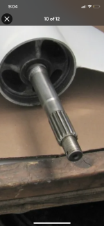

Here is my prop shaft.
I will re count the splines again.
I corrected a mistake I made earlier, I counted 13 splines, not 14, but will double check.
First 2 are mine, second one is the one on the eBay unit.

Yeah @racerone nailed it.
I wonder of your upper unit is from a 400 as well. I would confirm exactly what you are working with before proceeding.
Someone has swapped things out and didn't match it up properly.
(Did they swap the whole drive or just the lower unit ????)
