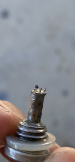

I cannot edit the post anymore, but here is the lower drive drain plug removed after about 3-4 hours or usage time.
The drain plug went in clean the other day when I added new fluid.

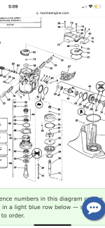

Serf27
Aug 23, 2018
167
I removed the lower drive to look at the drive shafts. Shaft teeth on lower and upper look to be in excellent shape. No wear or missing teeth.
The drive shaft in the upper drive did have some up and down play.
I read it was normal, due to the woodruff key for the impeller. Is this normal and correct?
I also see which part causes minimal side to side play.
Part 81 seems to be what’s allowing the drive to move from side to side about a 1/4” or less. Is this normal?
I believe part 35 is the one with up/down movement. It’s the shaft that connects to the lower shaft when the 2 are joined together.
