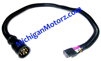

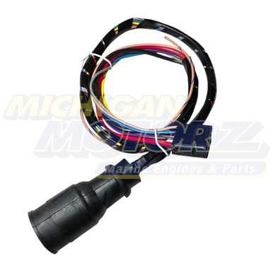

Do you have the harness out of the donor boat? you could cut the connector off and splice onto your existing boat harness. Or get a used boat harness for the plug. I think this 3 ft harnes could be spliced in to boat harness as I believe the engine has female pins

Bought the boat with no engine, drive or inner/outer gimbal. Bought the engine as a drop in so no donor boat . I realized today upon closer look that the one pin on the 9 pin is empty. So I may be fine. Thanks for all the help. Im gonna need it with this project.

Yes correct the one pin is unused. I believe they should work. You are smart to get a complete drop in vs piecing it together
