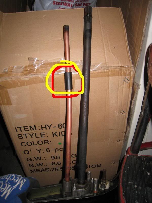

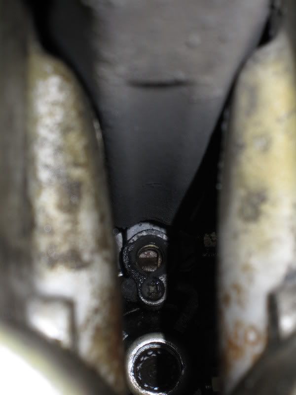

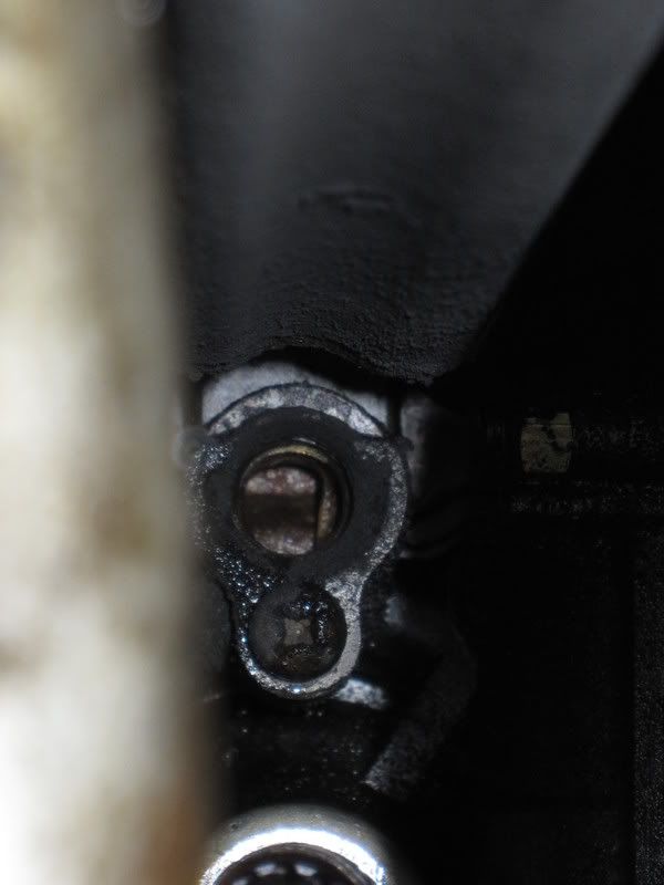

Hey guys, i took some picts of up in the middle unit, to try and see if the water gasket is still in there (not sure if there would for some reason be one that came off with the copper tube, and one up there) And this is what i saw... It looks like there is one in there, but it could also just be alot of sludge and grease... I haven't yet tried to put the copper tube back in with the washer all greased (lower unit still isn't here) But what do you guys think ?
oregonboatnewb
Dec 6, 2008
283
Re: OOPS Lower unit water hose Came with it ?
My new "to me" lower unit gets here sat, and i wanna get the water tube back up and in there today... Does the tube go directly in the whole in picture, or does that little rubber cover
Go around the top, and both pieces go inside at the same time... if so, do i put grease on the copper tube, as well the outside of the rubber ?
Thanks
Moody Blue
May 24, 2004
3,136
Well if it is what I think it is, that black tube belongs on the output of the waterpump housing. Normally, the water tube remains with the powerhead when removing the L/U. That black tube in the waterpump allows for easier alignment and insertion of the water tube into the waterpump when installing the L/U. Hope that makes sense.
From your photos, it appears the rubber grommet is still in place in the powerhead. That is the good news. The bad news is that it will be very difficult to "blindly" align and insert that water tube into the powerhead as you install the L/U. I would try my best to get that tube out of the waterpump and install it into the powerhead.
Are you getting the proper water tube with the new L/U?
emckelvy
Jan 16, 2004
2,506

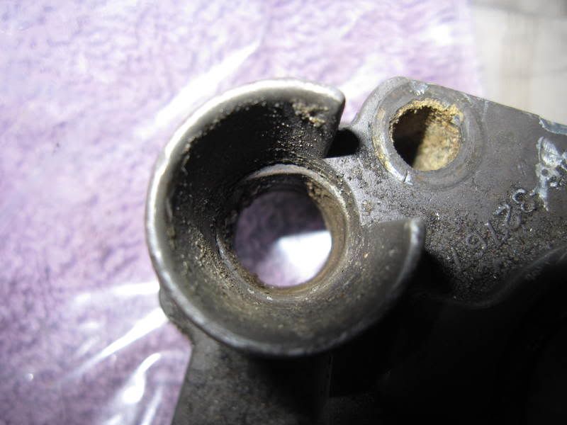

If the black piece is made of rubber and a snug fit on the water tube, it's meant to go approx where it is now. It serves as a 'bumper' to keep the tube from rubbing thru where it might touch the inside of the exhaust passages.
If it's made of hard plastic and fits loosely about the water tube, it's probably the water tube guide sleeve. The guide sleeve fits into the top of the water pump and helps 'catch' the bottom end of the water tube when you're installing the lower unit.
Note that you still need to get the copper water tube out of the pump body. Once the water tube is removed, pull the old rubber grommet out. Then scrape/clean out all deposits in the pump body where the grommet sits.
Then you'll most likely need a new water tube grommet for the pump body. Lube the grommet inside and out with some waterproof grease before installing.
You put the guide sleeve in after you install the grommet in top of the upper pump body.
Hope that clears things up a bit...........ed

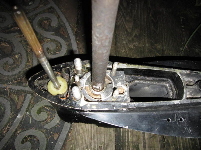

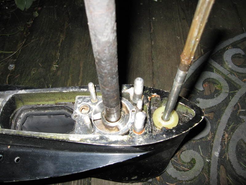

I got the Copper pipe off, all it took was a little heat, and alot of wiggling ! I see the grommet on water pump end now, it doesn't look amazing, thats for sure.

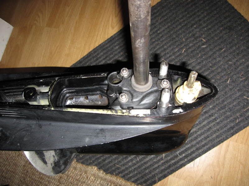

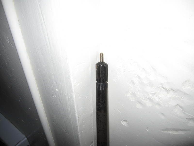

The lower unit i took off my motor didnt have this pin on the top of the drive shaft...
The one i just purchased does... will it still fit in the motor?
(NEW ONE BELOW) Old one above
Moody Blue
May 24, 2004
3,136
Encountering the same situation with the driveshaft on two L/U's I have.
From what I understand, that pin preloads the gears in the L/U. In older units, the driveshaft did not have the preload pin and relied on shims under the waterpump base to achieve the proper gear preload. The pin MUST be free to move up and down (it is sping loaded) otherwise you won't be able to properly fit the L/U to the powerhead.
I believe that the two types are interchangeable but waiting for someone more knowledgeable to confirm.
One thing you might check on that driveshaft is the condition of the shaft in the area of the waterpump seal. The older non-stainless steel shafts tended to corrode badly in that area.

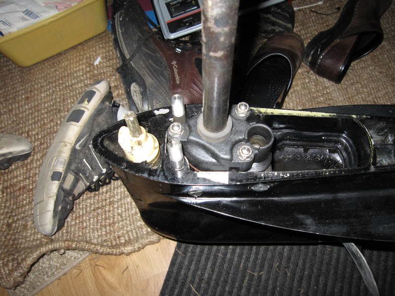

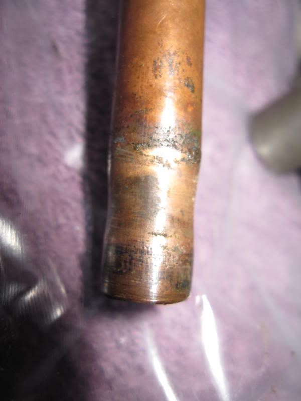

I think ima need a new copper water pipe... Got the new lower unit, and the old one
Kind of clicks into the new LU, but it wiggles around ALOT, i can move it 4-5 in back in forth on the top with ease... I think it got squished so much by the previous one, its very small at the bottom, and new lu water pump kit is not shrunk.

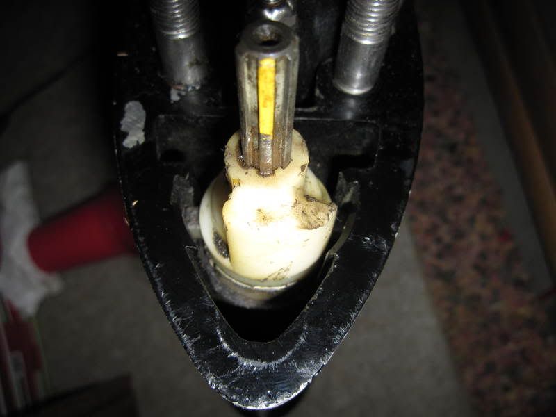

Also, i changed out this piece from my old LU to teh new one (cause it had a crack in it.) the guy who sold me this LU, put a mark on the spline to say that needs to face froward for the gear shifting to work... So i took off the plastic piece, and i'm not 100% i put it back on the right spline, does this look right ?

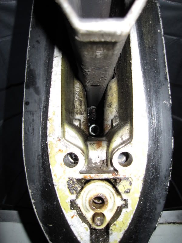

emckelvy
Jan 16, 2004
2,506
The previous description is accurate; the preload pin has to do with the lower unit and what type of bearing it has; but has nothing to do with the fit into crankshaft.

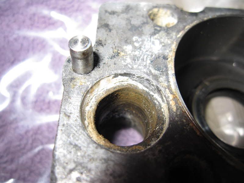

One thing to check, later-style lower units had a wider 'bolt pattern' on the (2) studs that stick up out of the top of the gearcase, just forward of the water pump.
Probably would be a good idea to measure your bolt hole spacing and make sure the studs on the new lower unit are spaced the same.
I've used the later-style lower unit on an earlier-style motor but had to file out the sides of the holes in the exhaust tower to make clearance for the wider-spaced studs.
Also, you may find (1) or (2) small dowel pins in the upper face of the gearcase where it mates up to the exhaust tower. If you do, check your tower for the matching alignment holes. I doubt you'll find any, if so, pull any alignment pins you find in the lower unit.
HTH...........ed
oregonboatnewb
Dec 6, 2008
283
Just measured the bolts that go into upper face... they seem to measure the same... And i didn't see any dowel pins either...
Old LU
NEW LU

Got the new copper tube today... can anyone verify that post #36's picture of the plastic piece i put ontop of the shift splines is lined up right... i put the white one on, cause the one on the new unit i got was damaged... and i didn't mark the angle i took it off... don't wanna put back on this lower unit, only to have it not shift.
