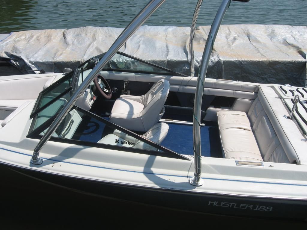

I currently own Frisco's 1982 SX190 Glastron he rebuilt in 2010 with Durabark. It has held up great--comfy on bare feet--cool in direct 100F sunlight. The only issue is because of it's texture, is hard to clean. I have to scrub with commet & a brush to clean. I anchor the boat at a local sand bar most summer weekends and it stays dirty most of the time. it makes no sense to scrub it clean then hang at the sand bar the next day. The boat is tucked away for the winter but can send you photos of the dirty floor if you want.View attachment 178508
Could I see the pics? I'd actually like to see it dirty. Stuck between gel coat and durabak.
