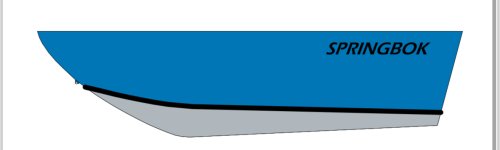

With silver potentially being tougher to paint I’m going to get more of a glossy grey. The blue will be on the sides and the grey on the bottom. I have a photo showing the paint scheme I’m thinking of. Ignore the black stripe between the two colours as I don’t think I’ll do it.
As long as you can keep a consistent pattern and don't sag it, it wouldn't be that hard. It would actually be a bit easier with single stage because it builds thick enough to cover the sanding scratches better. The downside is that if you sag the paint, you might have to respray the side.
Spray the blue first to get a feel for it. Any sags in a solid color can be sanded and buffed out.
Would you be fine with doing the stripe with vinyl striping? It would be the perfect thing to hide any wonkiness where the colors meet.
The vinyl stripe is something i didnt think about but in terms of hiding the painters tape lines it might be the way to go! I'll look into that, I'm trying to figure out my rub rail insert replacement issue right now before i go ahead and start sanding and prepping for paint.
