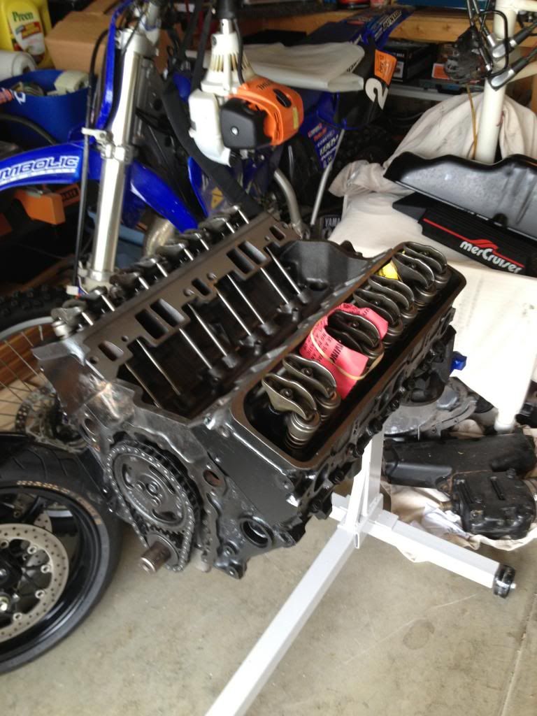

I have a photo of motor without manifold on, but the insert image is not working with my imac. I am hoping to get photo up so someone can verify flat or tappet. Any suggestions on an alternative way to get photo up? thank you

Re: Can you verify roller or flat tappet lifters from this photo?
Pull one out and look. I would think the break in would be the same either way - varied loads and speed first 10-15 hours.
Flat. Roller lifters have a locking plate (nothing like that in that photo) to stop them rotating.
Like Chris mentioned roller lifters have a bar connecting two together so they don't spin.
Hydraulic lifters don't.
you would see these in a roller
