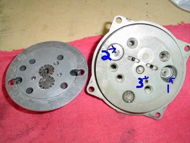

Its just a BB from a BBgun...looks like a small ball bearing. I will add some good pump pix in my next post..

If nothing else, these pix might show people to keep their paws out of these things if they don't know what they are doing....
<br />and...<br />
<br />and...
<br />And the last..
<br />Someone here at this forum posted these before, so I cannot take credit, but I am FOREVER grateful for the person who did post this first. Simply some terrific people here that are glad to help. :cool:

Seems like the last didn't make it...here it is..
