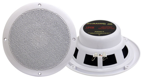

Oh yeah, almost forgot! The marine speakers arrived and are installed. They sound great considering they are driven by a low watt OEM US Marine branded AM/FM cassette radio from 1984. The important thing is they fill in the eyesore where the original speakers were. They were missing the grills, frames rusted and rust stains running down the vinyl. Not any more!
