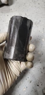

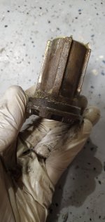

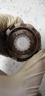

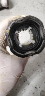

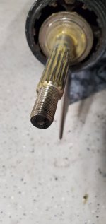

I took it apart. I have the flo-torq hub and it looks fine; no cracks or visible wear. I am truly perplexed.
Jul 9, 2021
11
Here are some pictures.

alldodge
Mar 8, 2009
44,283
Reading your first thread I would think about disassembly of the lower. There is something wrong it the shift area.
Update. Seems that the clutch engages when the lower unit is laid down.
Jul 9, 2021
11
I've considered it but at this point I'm just looking for a new/used outdrive. I'll refurbish the old one over the winter and sell her. If anyone wants a 1.81 ratio alpha one gen II let me know in about three months.
