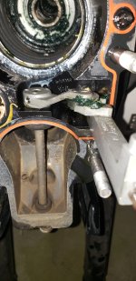

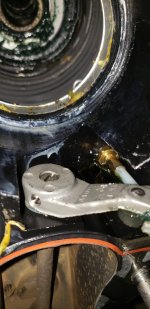

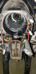

hi guys in the lrocess of taking off the Alpha one drive when i put the gear to full foward prop doesnt click or lock if i spin it CC ? only if i put the gear a little foward like at 10 o'clock it then will click but Very hard? i took out the drive just fine it looked like new in there to my suprise . But does the shift lever thingy look good ? it looks off a bit ?

If you left it in forward when you took it off. It should go back in on (you can usually see the gear selector to see if it’s locating properly once it’s on too). When in forward with the drive all connected up…the prop will only lock one way. Same and opposite for reverse. I’d think you’d need to be at or beyond the 10 o clock position for it to engage forward anyway. Not sure you have much to worry about, unless I’m missing something.

mercruiser Alpha drives must be in fwd for removal and install, your pics look correct
if unsure on the procedure ask for a manual
