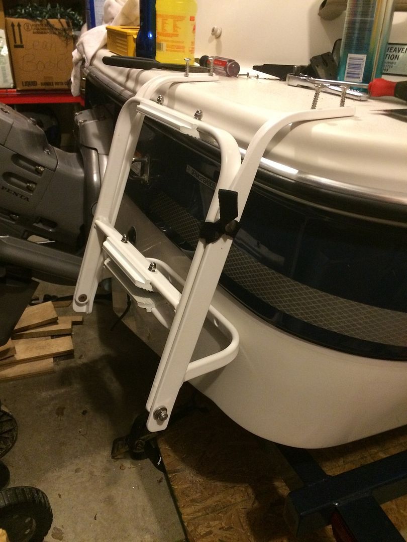

No Title
[FONT=&quot]Below is a pic that gives you a general idea what the ladder looks like and how it mounts to the hull. Why they mounted the ladder to the hull in this fashion (thru-hull screws below the waterline) is beyond me.
The thru-hull screws that hold the ladder are 1/4" (measured at the tips of the threads) stainless wood screws that are 1-3/4" long with full length threads and stick out of the surface of the hull about 1/2" when holding the ladder. The ladder brace does not sit flush against the hull, but at a slight angle, so you can see a screw thread (looking from the top down) when the ladder is installed (if installed with not sealant). The ladder sits flush on the top where it interfaces with the swim platform and this part of the mount works great.
Ideally, the repair for the hull screw holes will allow the screws to be torqued fairly tight to hold the ladder against the hull and limit movement, but it seems there would be additional stress from a shear perspective that would push on the screw head if someone "big boned" in the family used the ladder. I am not sure if the g/flex + 404 would provide any advantage over the 105/205 + 404 in this application, or if altogether different approach would be better. [/FONT]

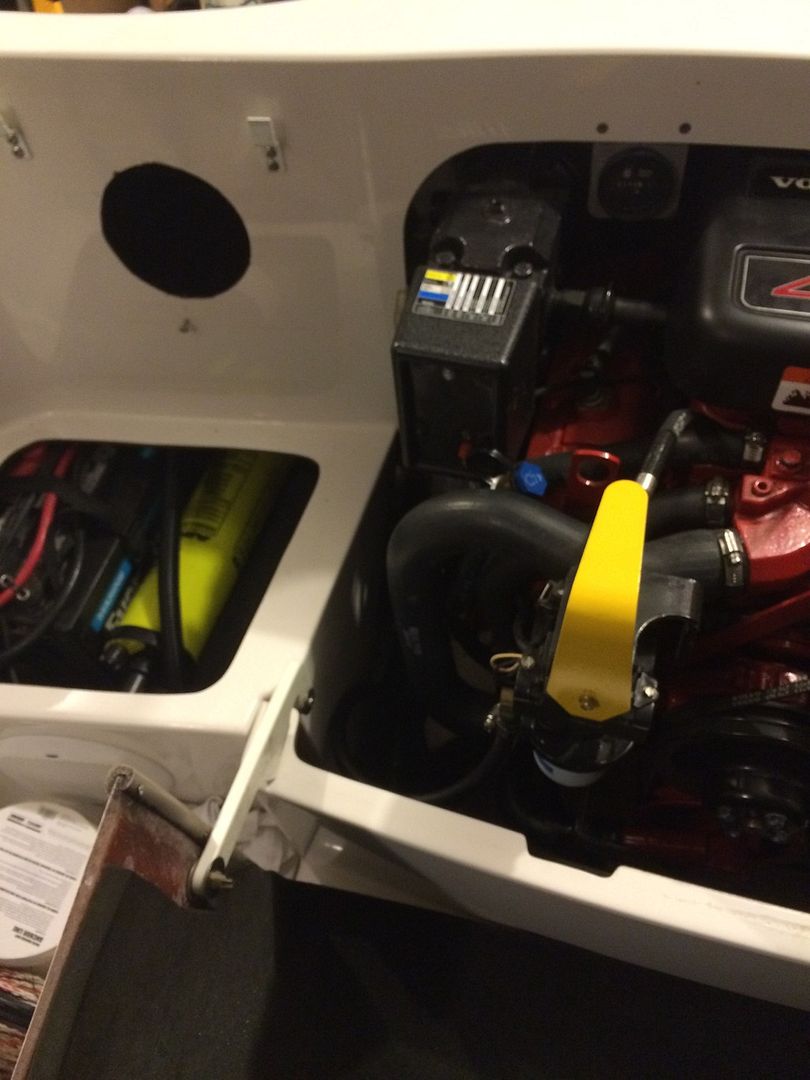

So here are some pics of my boat that will hopefully illustrate how it is laid out.
Here is a pic of the back of the boat with the ladder, note the integrated swim platform and the lower ladder brace where the two screws go into the hull:
Moving to the inside, this is a pic of the starboard side of the stern from the inside of the boat. The hole in the liner beside the engine is where the seatback for the jumpseat normally goes:

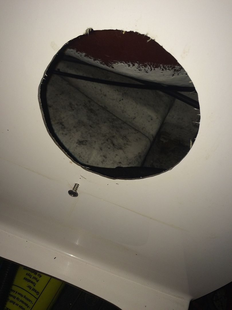

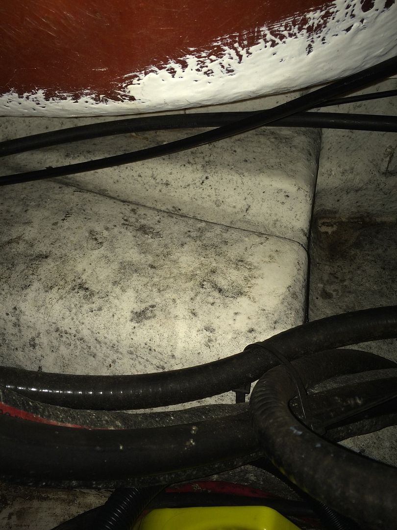

If you peek into the hole behind the seatback shown in the pic above (facing toward the stern), you see this raised area that I can only guess is filled with foam. You can see the stringer in the lower right of the pic. This raised hump would need to be cut open and the foam beneath dug out to get down to the screw holes where the lower ladder brace mounts. Not sure how much of this hump would need to be removed. By the looks of it, I would say the wood I am seeing in my holes is likely glassed in underneath this thing.
A closer peek:

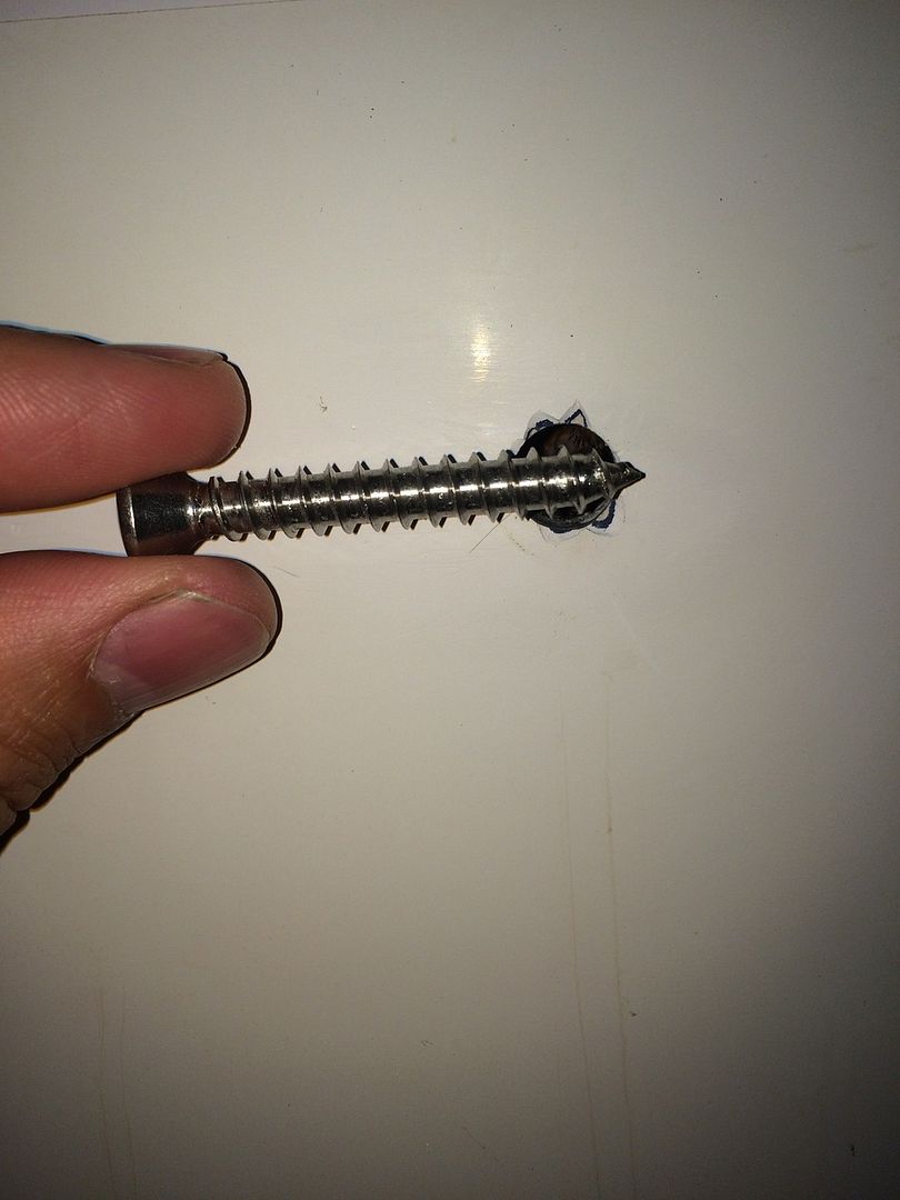

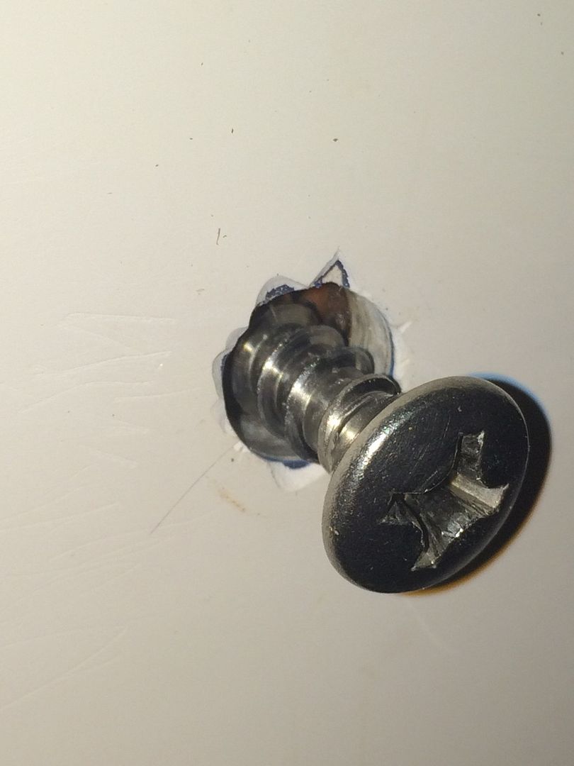

Finally, a couple pics of the screw and the hole that has been drilled out to 3/8":
DeepBlue2010
Lieutenant
Aug 19, 2010
1,305
I can see the wood behind the hole in the picture before the last and it is not drilled though. It holds the screw right in the middle of the hole unless my eyes are playing tricks on me. unfortunately, the screw is hiding this area in the last photo. If the wood is gone ( drilled out) by the 3/8 drill bit, how the screw is being held true to the center of the hole like that?
BTW, are you sure this is a 3/8 hole?! Can you measure it for sure

DeepBlue ? I confirmed that the hole is 3/8? in diameter. The screw was lying on the bottom of the hole and the pic appears to be an illusion that it is ?floating?. It is possible my screw is larger than I measured. There are some splinters in the very back of the hole that contact the screw but do not make enough contact to hold the screw centered in the hole.
