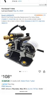

By the way the fuel pump I purchased is not OEM it’s from Amazon , do you think that’s the problem ? It’s exactly the same of the original , do you think I need to install the original???
Freeman1982
Petty Officer 3rd Class
Aug 19, 2020
89
Never go WOT in neutral.
Check fuel pressure under load (in gear)
This is the fuel pump I installed last year i ordered it from Amazon , do you think this happening because it’s not the OEM ?
no, I think you are down on power because you have cylinders in the 120 psi range.
post the cranking psi for each cylinder. if you have two cylinders next to each other, you could have an exhaust valve issue from a leaking manifold.
also, post your fuel pressure readings under load at WOT. that is in gear, throttle mashed, preferably coming out of the hole. this will tell you if you have a fuel flow / pressure issue.

This is a 5.0L 270HP FI Volvo? If so...I'd be double checking that fuel pump.
I say that as mine went in the Four Winns - same engine. The cost of the pump alone, from Volvo was $1k. This is one area I would not cheap out on. The cost of the Amazon unit makes me pause.
Freeman1982
Aug 19, 2020
89
So you think fuel pump could be the problem because it’s not OEM ????
briangcc
Jul 10, 2012
2,429
I think it *may* be part of your issue if it can't supply enough fuel to the engine.
Given the price point (at 1/10th the cost of OEM) and suspect manufacturer...I'd be checking that.
When mine went, there was an audible noise where you would hear it run, the noise would stop, the engine would die. It was a very nasty idle out from the ramp and back trying not to get hit from the folks behind me.
52,751
fuel pressure taken at WOT will determine iff you have a fuel pump issue.
since your compression is iffy based on post #1. you need to do a good job taking compression readings with a good gauge.
then you need to take fuel pressure at WOT under load. 50 psi is the bottom of the spec. pic in post #3 was taken in WOT in neutral. the motor burns maybe 2 drops of fuel in neutral, where it burns 20 gallons an hour at WOT under load
