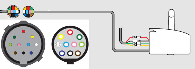

Ok >>> so I finally got around to putting this together ... Pretty simple and straight forward .. NOT !!! I picked up an old used harness FROM a 703 control box .. I kept about 6 feet OR WIRE from the female connector and hooked up all the wiring and switches .... Tried it out and nothing !!! Long story Short >>> In the harness female connector, the 12V+ and 12v- were in reverse positions.. Opposite that of my motor and any diagram I had ... I wound up using the black as positive and the red as negative . I don't really understand why this occurred ????? All other wires were in the proper position...Did Yamaha change harness part #'s ??? ANY ONE HAVE AN ANSWER ???

picture of harness and control .. still can't figure out why this harness had the 12v neg and pos in opposite positions from the engine and any schematic I looked at ... The connector is intact and was not modified ..... So To be clear ,,, the positive pin on the motor lines up with the negative pin on the control harness and the negative pin on the motor lines up with the positive motor pin !!

So What I have on this harness is just what you posted ...EXCEPT !!! the black and red terminals and wires are opposite the drawing on the harness .... The motor has the red wire at 12 o'clock and the Black wire at 6 o'clock... The harness has those two wires in opposite positions... I had to connect The harness Black connects to the motor red !! And the harness red to the motor black. All the other wires are in proper position ... The harness was an old used harness that was lying around the shop .. I figured it out When I had the connection of red to red and black to black and my meter was showing reverse polarity . Once I connected harness black to motor red it all worked ... CRAZY !!!! ..

Basically the hot lead and the ground wire in the harness are the right colors but in opposite positions ,,,,, so the black ground is actually 12v + and the red at 12 o'clock is actually 12v - .. The Red from the motor lines up with the black harness wire and the black from the motor lines up with the red from the harness.
I am guessing that someone rewired your used 703 ten pin harness.
Below are three different illustrations showing how the side of the ten pin harness towards the motor is configured.

Boscoe 99 >>>I could not open the pictures you sent .... BUT... I considered the that someone reversed the pins ..... If that was done, whoever did it , LEFT NO EVIDENCE THAT THE CONNECTOR WAS TOUCHED .. But as of now that is the only reasonable explanation... I also wondered if the harness was not a Yamaha, harness, but maybe from another brand motor that Yamaha actually made ????
