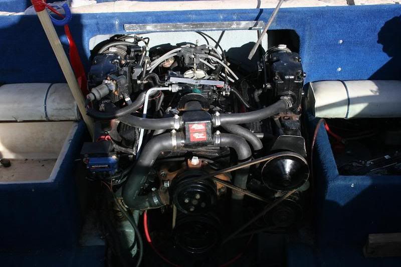

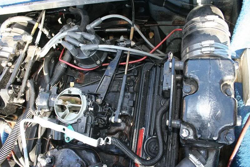

So I made a post on Craigslist looking for a new alternator and starter
Wanted: 1988 Sea Ray Seville parts (alternator and starter) (alameda)
NEED ALTERNATOR AND STARTER FOR THIS ENGINE. The boat I have is a 1988 Sea Ray Seville.
Engine Year: 1988
Make: GM (Chevy Engine)
Model/hp: 4.3L/175
Displacement: 4.3L (262 cid)
Drive Unit: Alpha One
Gear Ratio: 1.84:1
Full Throttle Engine Operating Range: 4,400-4,800 rpm
More info:
http://img.photobucket.com/albums/v369/El-Diablo-of-dt/Boat Engine/7-23-2008pics004.jpg
http://img.photobucket.com/albums/v3...BoatEngine.jpg
http://img.photobucket.com/albums/v369/El-Diablo-of-dt/Boat Engine/7-23-2008pics007.jpg
Some guy replied to me:
" I have a new starter and a good used alternatorthat came off a 1991 Mariah with that same v-6.. The block cracked and I bought the starter thinking the used one was bad. The engine had 165 hours on it.. I bought an engine package with 220 hours and installed it useing the old starter because it was already off the block. For the new starter and used alternator I would need $175. Don't want to sell just one. I am in the central valley, but headed to the bay tommorrow for a car. Please call if interested."
you think these are the right parts and this is a good price? sorry but I don't know much about parts.
