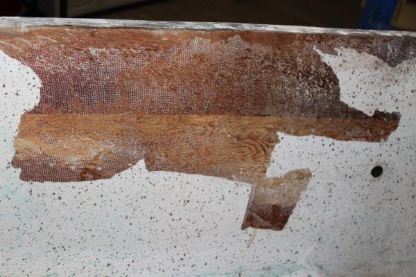

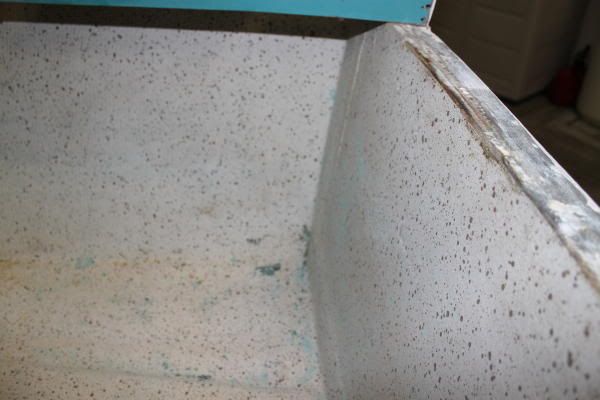

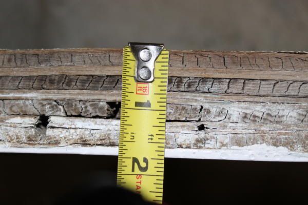

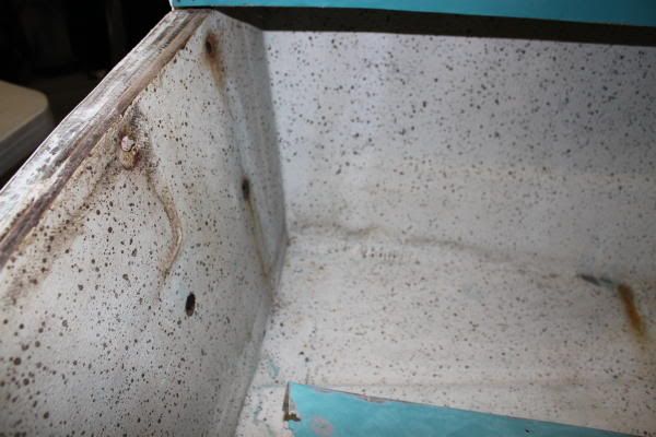

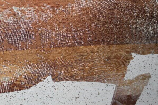

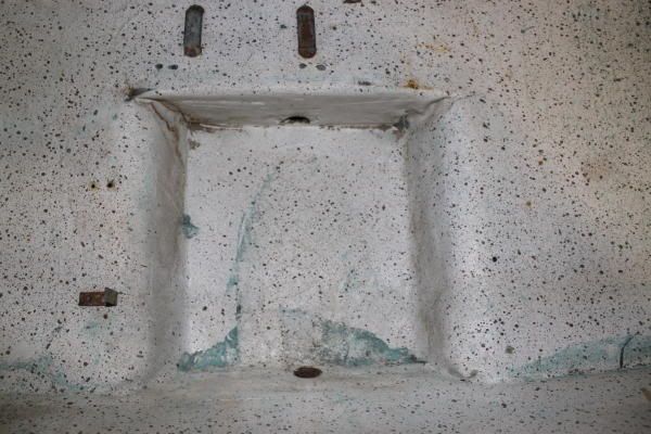

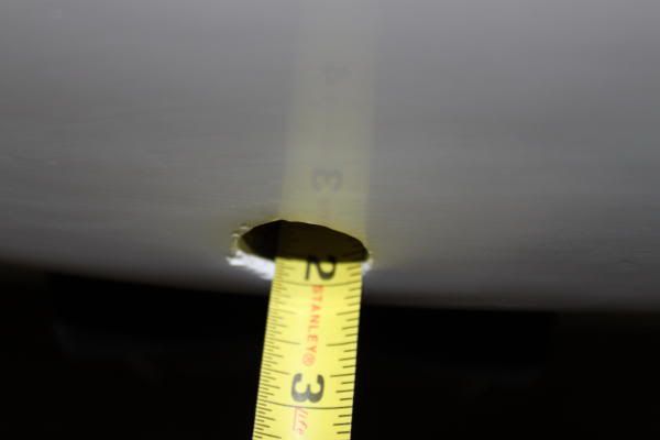

Ok so I took some pics of the transom up close. What is interisting to me is how about 4-5 inches from the bottom the transom goes to 2 inches thick but the top is 1.75 inches.
What do you guys think?
This is the bottom drain hole!!!
ezmobee
Mar 26, 2007
23,767
Re: Restoration of my 1965 Glasspar Avolon
I think it's swollen which is giving you that extra thickness. I don't like picture number 4.

Yes, actually I had questions about that. Right to the left is where the motor clamped down and is pushed in a good 1/8 of an inch. So my question would be did the motor compress the wood denser then its origional state, or like you stated the wood has swollen? Wouldn't that mean the wood has been saturated by water for a long time, and if so why no rot, or sponge?
If the wood has swollen, does that weaken the strength of the wood?
In my years of service on the water, without a identification plate the discretion is within the abilities of the officer. a 110 is sooo close to a 90, I highly doubt that it would register as a red flag.
Woodonglass
Dec 29, 2009
25,932
Hey wb,
Take a look at my transom wood
IMHO you have had some water in there at some time in the past. That wood is checkerd and the plys have started to separate. Now it might have sat in a DRY place LONG enough for it to have dried out but it has been wet at some time and Swollen and parts of the wood have receded while others have stayed expanded. If my transom looked like that and I wanted to hang a 90 HP motor or bigger on her, I would DEFINITELY be replacing my transom. It's your boat, so do what YOU want.

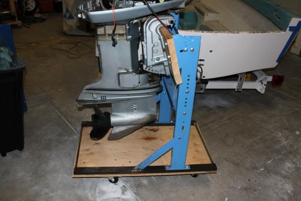

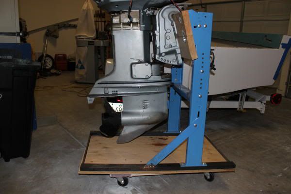

Ok I had a really good night tonight. I went and picked up my new motor for our boat and I am very excited. My close friend Mike from Martin Marine went over the motor with me at the guys house. He has been building, selling, and maintaining boats on the water for over 35 years. He as well as the owner Ken and Kate assure me this is going to be a great set up for me and the family. I took some pictures after I took everything off that we new we were going to be replacing so I can feel comfortable with what I have. Today Mike ordered all of the parts that we both agreed would like to be replaced. We also wanted to check out the pistons, sleeves, and condition of what the motor has been like in its life time so far.
Check out my motor stand I built this and it should last a lifetime and can hold up too 900lbs.
As for the transom, we looked at it hard and cannot explain what had happened but if you can tell from the pictures, the wood underneith the fiberglass coating is in terrific shape. Mike and I went over it with a fine tooth comb and this sucker is hard as a rock. Sounds like you are knocking on a door. So we both agreed that if I were to strip the rest of the fiberglass cloth off and sand it real good, I can apply one more small layer of wood and epoxi that to the rest. Then throw on three layers of Biaxel glass with epoxi and this thing will hold be rock solid.
The only answer that we can come up with for some swelling at the top maybe from rain sitting on the exposed wood and over time this moisture can sit and swell up the exposed layers. But also makes sense why the rest of the transom is so solid and has no swelling or rot anywhere.
