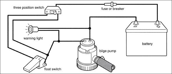

Also, will a simple SPDT switch work on a bilge pump to turn it automatic vs manual? I was thinking a DPDT would work as well, but the wiring for that type a switch seems complicated based on the original switch, which broke off.
Sorta yes but just a refresher first........The auto side power you don't touch/wire through any of the dash switches, normally (and best practice IMO) it is a feed from the battery that goes through the float (auto switch). The manual side is just that same power source that parallels the auto side, so basically any switch would do, simpler (SPST) the better. Jumping the throws together your SPDT I recon would be fine as well in a pinch.
I guess having to "manually" put a switch into "auto" doesn't make much sense to me. I suppose if it a switch that is a momentary manual that self centers back to auto, that might be okay. But, seems the less switches for the auto's power path, the less likely to have issues down the road.......

As for the bilge pump, I prefer a switch that allows full control of manual / off / automatic. There is usually a center pause position for off. - Grandad

As for the bildge pump, I was thinking a SPST switch as well now. Since the automatic wire will connect directly to the battery, the manual will just trigger if I need it to turn it on when I want.
That's the way many bilge pumps are wired. However with that setup, if the float sticks in the on position, you can't turn it off. You'd have to pull the fuse which leaves you without a functional pump until you re-insert the fuse when the water level rises. With a 3 position switch, you're able to completely over-ride the automatic function. - Grandad

Guess I don't trust myself enough these days, In the world of "ifs" ........I wonder but, thinking of the two evils of Murphy's PLLC, I believe I'd rather have a continuous or even a non-continuous run rated pump stuck on and pumping water, air, oil, fish guts and chessy puffs then perhaps walking away from my boat, getting half way to Cabo/Beer-Thirty/2AM and wondering........"Did I switch it to "auto" on a "manual / off / automatic" or "3 position switch" setup and "what if a hose/fitting/roof leak during heavy down pour, whatever, springs up in my boat" I'd be making trips left and right, wearing a path to my boat
....I've had to turn around too many times in my life because of the in/famous "S**T!!, did I leave the Iron plugged in or not" or "did I remember to lock the front door" maybe it's just me but, to now open that door with a boat? Ummmmm
Over the years of moored boats, I have seen a good hand full or walked upon enough boats sitting at/in process of going to the bottom of their slips because the pump simply didn't work, can't image if a guy's pride sunk because he forgot to manually flip (or the switch got bumped "off" by my famous switch bumping dog's butt) a switch to "auto" from "off".......ouch.
Perhaps just a two position switch would allow me to sleep better I suppose tho.......
I moor my boat, OP never said either way but, thinking just tying up and going in the lakeside bar/restaurant, I'd still have issues trying to recall if or if not each time i'm sure. Perhaps I'm just over cautious and too forgetful eh?

You could add another bilge pump, fully automatic, Just set the float higher than the other pump. If the one fails, the higher one takes over. That would eliminate the forget factor.
