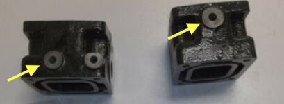

However, and my question is . . . there are 2 types of extension blocks that I have found . . .
Straight riser blocks
Which would NOT be a good choice for the closed cooling setup - IMO.
Then there are these . . .
Which have small channels molded in between the 4 coolant ducts surrounding the exhaust duct. My thinking is that this will allow greater flow from around the extension block.

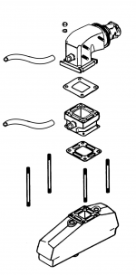

My plan for adding the extension block is diagrammed below . . .
I want the extension block to be part of the 'coolant' flow through the exhaust manifold, leaving just the elbow to have raw water (salt water in my case), as it is now.

Agree with flow diagram to make the riser part of the closed system

My take is the straight riser (first one shown) will only flow through 1 of the 4 channels. The other 3 channels have no way of passing water to the outlet fitting on the side of the riser block since there will be the block-of gasket at the top of the riser. Shown in red on my last picture.
Unless there is some internal passageways connecting the 4 channels within the riser block, which I sort of doubt.
I just don't want to buy the 4 riser blocks needed and have a mess on my hands. I'm thinking the flow will look like this with the solid block (first) riser . . .

I'm thinking it would be better to separate the iron (riser) and the stainless steel (elbow) for longevity. So, I probably will go with the 'second' style riser that I showed and put the block-off plate between riser and elbow.

The parts have arrived . . . Looks good. Here they are, showing both top and bottom surfaces.
One nice surprise is that the extension blocks have openings between the 4 main ducts as evidenced by the twist ties I inserted through one of the passageways. So . . . these extension blocks should support plenty of flow for the closed cooling side. (y)
I'm not sure why there is the small surface channels between the main coolant ducts, given that there are already 4 passageways molded in. :unsure:
