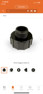

I’m thinking this approach may be easier than trying to keep the hose attached at the back. Is this the kind of part that sits on the intake portion of the raw water pump? B595D4FC-15AE-4C56-9253-5625FBCC14FC.png

Have you done it this way before? Seems like that black part on transom mount is metal and I don’t want to scuff it with the hose …trying to think through plastic adapters that may work. Any suggestions?

That part is actually plastic. and they can crack and leak!

If you feel uncomfortable just shoving a hose in there and securing with duct tape like thousands of people do, undo the clamp on the other side of that fitting you circled, then clamp it on your hose. You have to inspect the fitting anyway

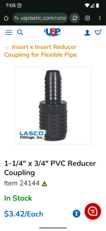

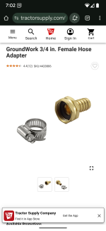

Or if you want to make a hose rig like I use when running the motor on a stand, you need something like
And a section of 3/4 hose
And an adapter like this
And a section of 1-1/4 hose
And connect it to the raw water pump
