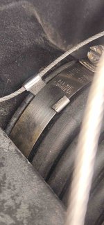

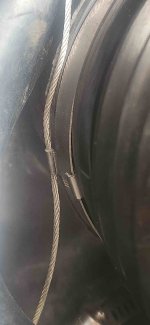

Thanks, Lou. I did note the orientation of the bellows per the instructions, I put the gap for the hose clamp screw cage at the 2 O'clock position. I also made sure that the ridge in the bellows fit into the groove in the gimbal housing flange.
The hose clamp band is positioned in the wide groove made for it and the screw cage is at 2-oclock. The hose clamp is tight but not too tight.
HoseClampUJoint_InPosition4_resized.jpgHoseClampUJoint_InPosition2-Resized.jpgHoseClampExhaust_InPosition2_Resized.jpg
