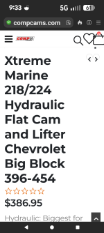

I got a marine cam from comp cams cL11-232-3.Flat tappet lifters.it does says replace valve springs.do you know which valve springs from comp cams to get and can I use the original caps and keepers or do I need those too?
I would suggest you contact Comp Cams, they would be the Best Source. Due to changes in Valve Train Geometry, you may need to use Roller Rocker Arms, and possibly slightly different length Pushrods
53,314
Post a link to the cam. Is it a marine cam? Need the valve timing.
Which heads? Oval ports or rectangular?
I don't know how to post a link to the forum.
It's comp cams extreme marine product #cl11-232-3
Oval port heads.i posted the head casting number in the beginning of post.Also pic of specs are above.

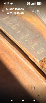

So I have gave you the serial number and Id tag to the parts engine.
The engine on the boat has the same block casting number 1401544.
But the serial number above the timing chain cover is 10617alb.There is no id tag on this engine.I hope these 2 are close.also the head casting number is 14081045 which is different from the parts engine cast number.I hope these still allow parts interchange of cam and lifter and intake.also does 9 or 15 manual work for this boat engine?

53,314
The stamping on the front of the block is meaningless in marine applications. The serial number is on a tag riveted near the starter
