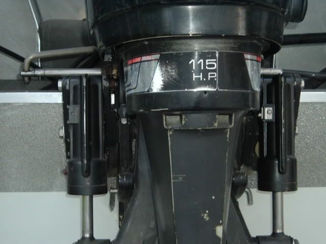

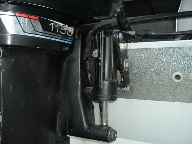

Plainsman
Apr 2, 2006
4,062
Re: set-up of power trim and tilt unit
Here is a picture of mine
