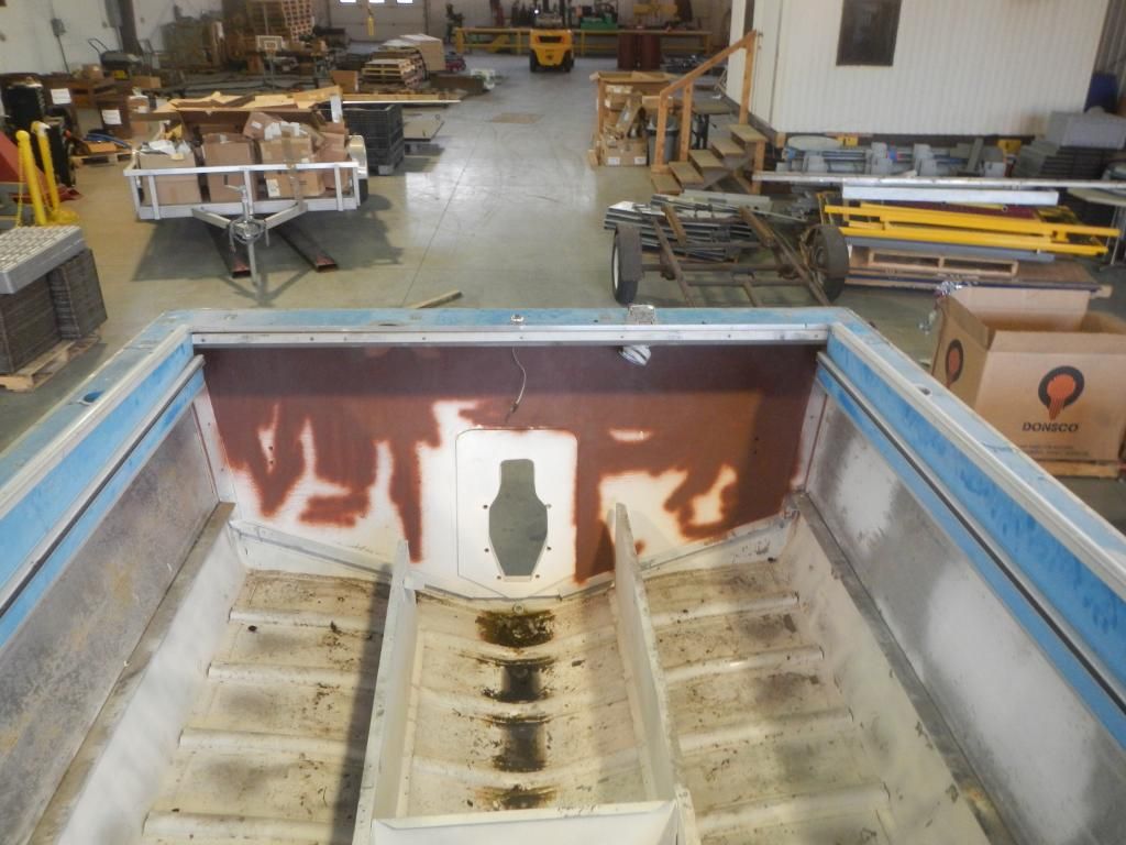

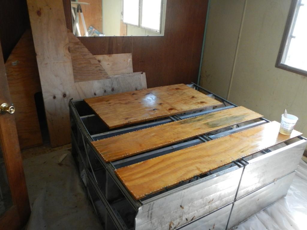

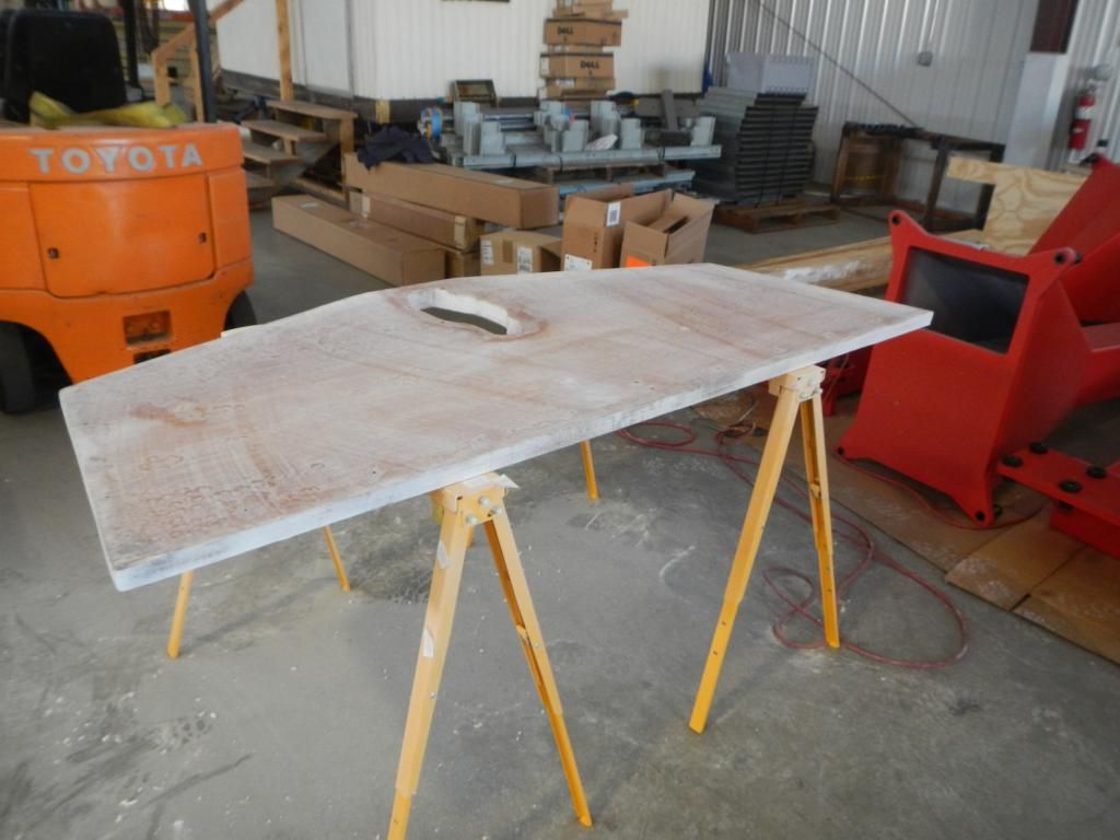

The transom and floor are entirely coated in epoxy now. The transom has been installed and once I get the aluminum stringer back from the weld shop the floor will go in. The stringer had some areas that were torn up at the mounting flanges. I don't know when this happened, but they were loose in the bottom of the boat when I tore the floor off.

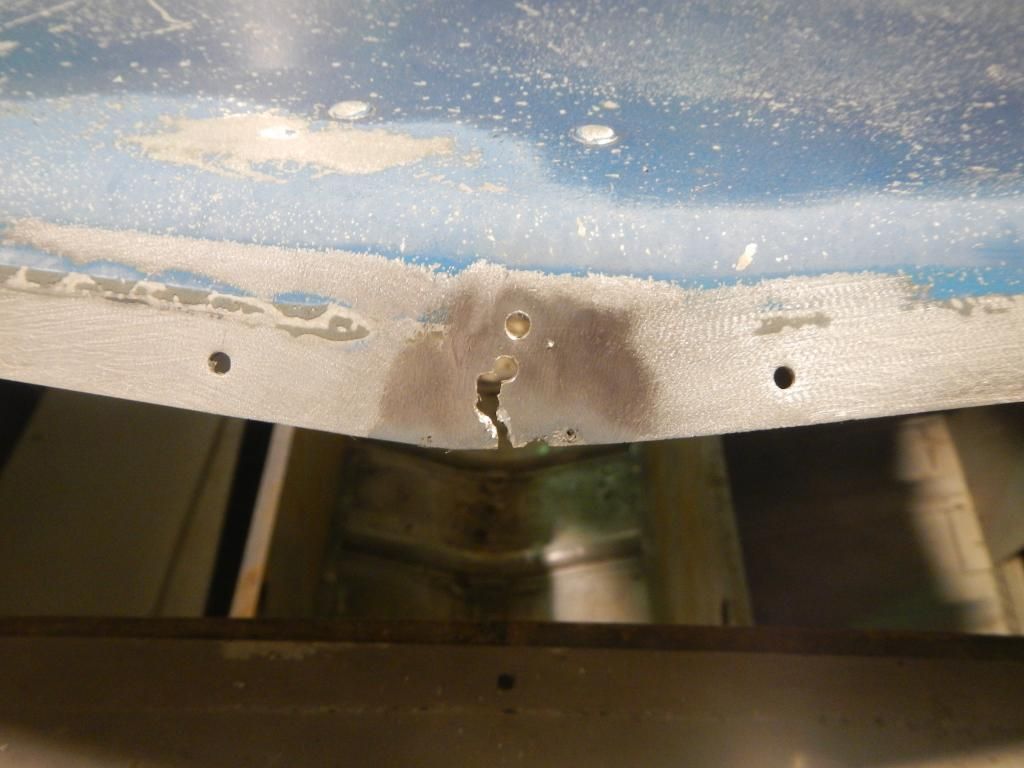

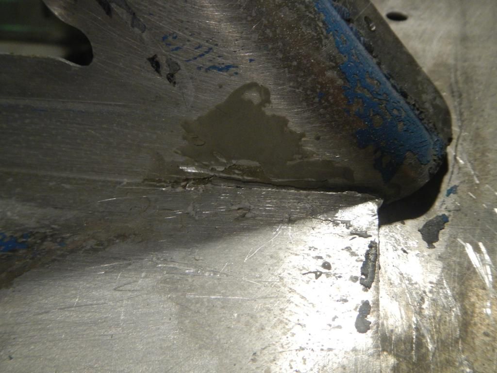

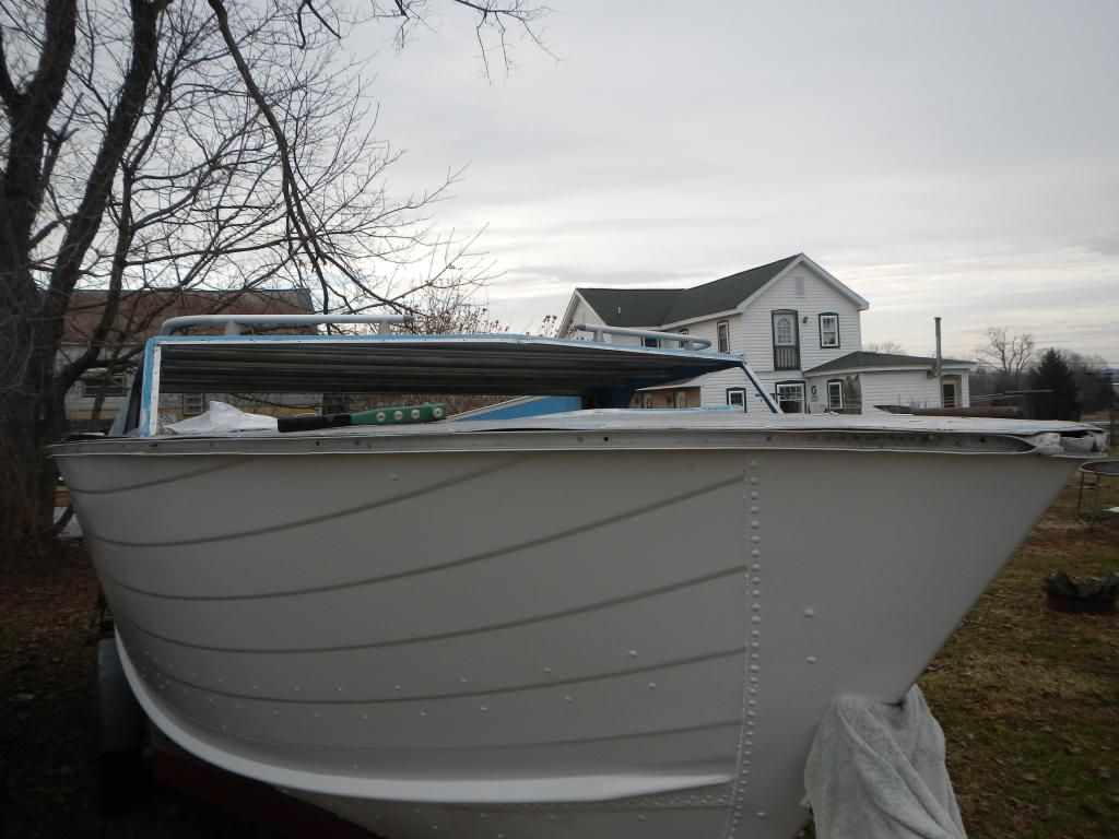

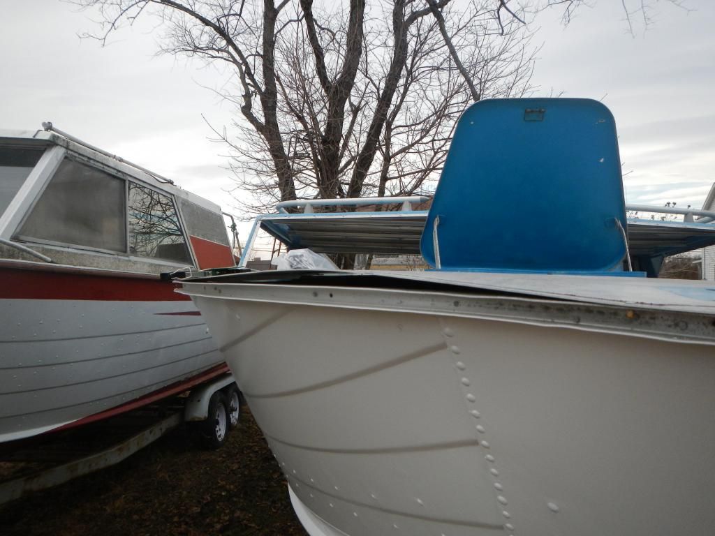

Back to today, I am working hard getting all the holes filled and cracks repaired so I can finally paint the topside! There were holes everywhere, and 3 cracks that were problematic. I believe all is fixed now, it just needs a lot of sanding.
I also had a problem in the winter, the snow load build up and broke the brace I had i the front of the boat to support the roof of the cabin. When it buckled under the load, it ripped out a ton of topside rivets. They have now all been replaced except for the few at the front window. I am leaving that loose until the painting is complete because the gasket gets tucked under the seam.

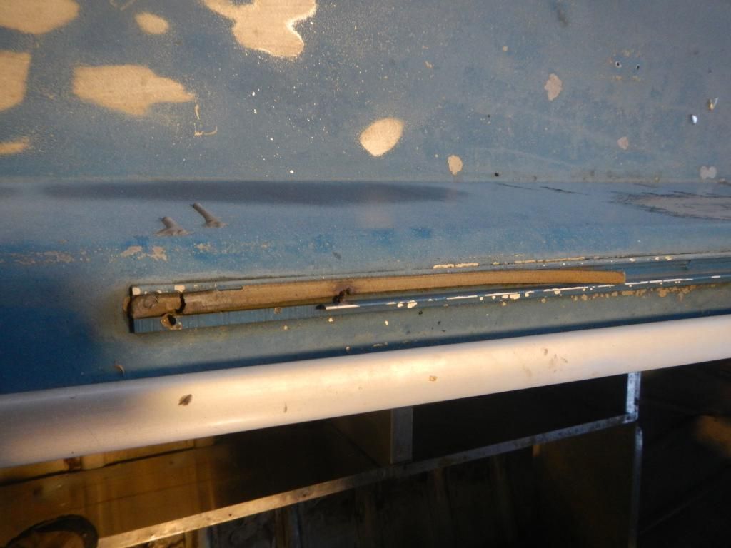

I did have a question, since I will be painting the boat without the rub rail installed, should I use some type of calking after the rub rail is back on to get it water tight? Would something like 3200 marine silicone be the trick for this job? I just want to make sure I get it right the first time and don't have to mess around with it once the paint is on.

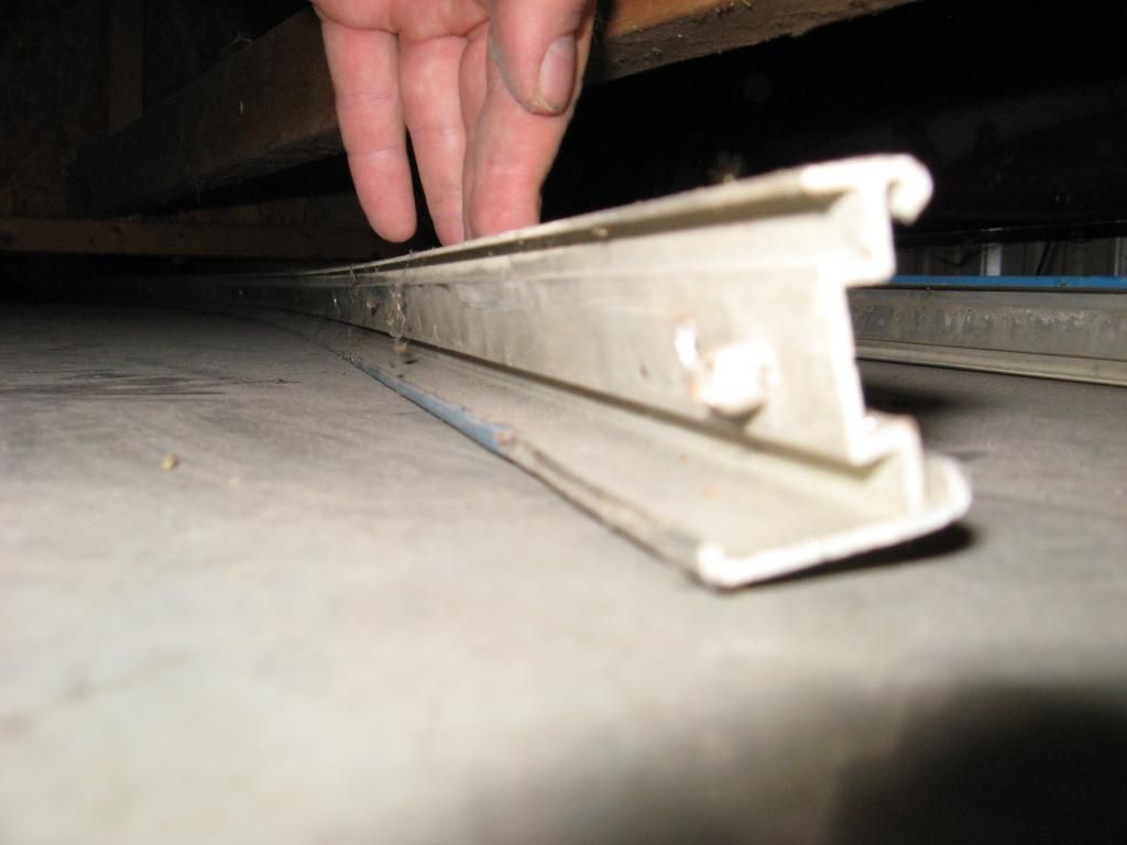

Also, for the track the windshield slides in. I assume this should be tapped and not painted. There is a foam gasket in some areas of the track, is this critical? I want to know if I need to source it and replace it when the windshield goes back on.

For that window track...
You may want to paint that up as some small slivers of it might be in view and it would look weird. Keep it a thin coat though so the windshield slides back on easily.
The foam is important as it'll give the windshield a nice solid/tight install.

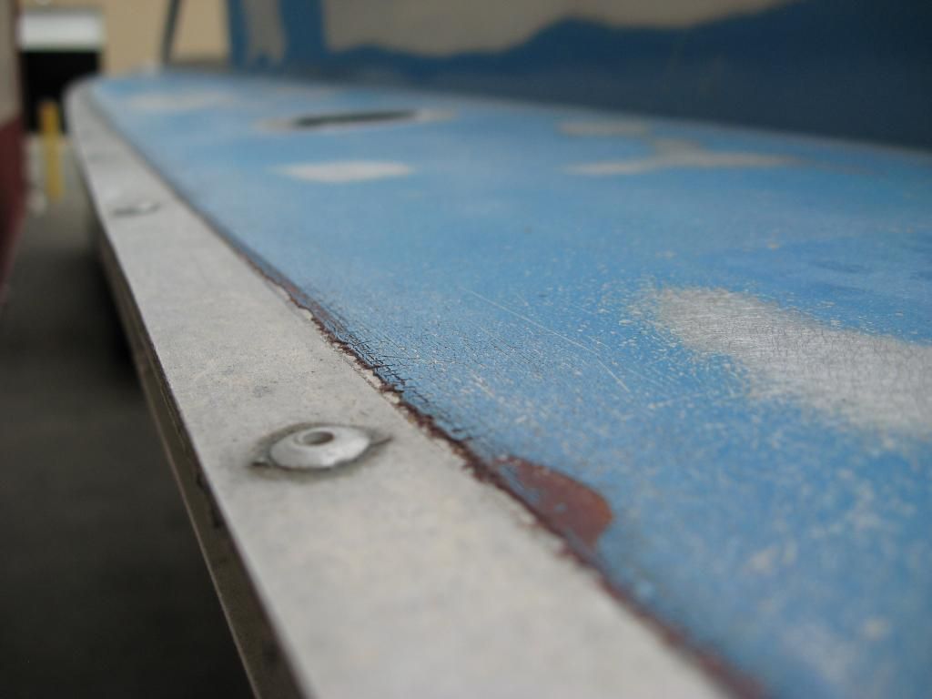

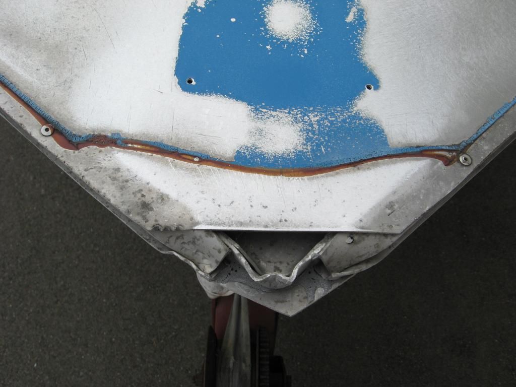

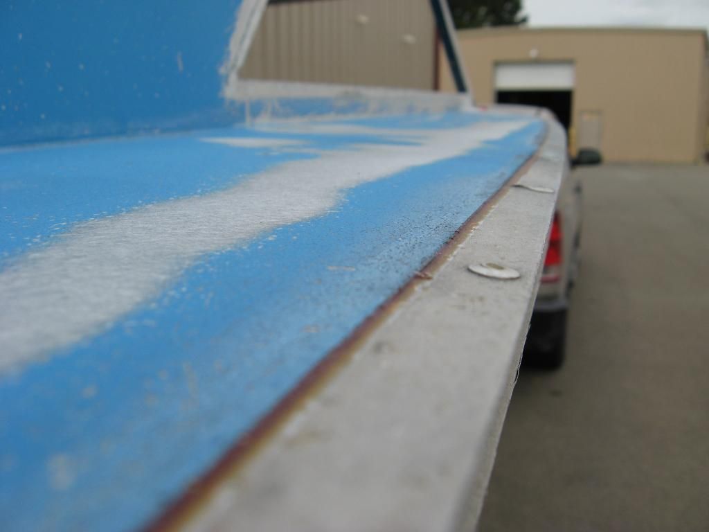

I just snapped some quick pictures of the top of the boat. I don't know if I will get to work on it tonight, I have a car hood that is about to be painted. Hopefully that goes well and I can put in some time scraping and sanding.
The brown is an epoxy coating of some sort, it is the entire way around the perimeter on the top side of the rub rail. It's hard and nasty to get off, if it wasn't for this ridge I would be painting by now.

That looks like the same stuff that seals the sides of the bow plate. And cracked/weathered the same too. I don't recall seeing the stuff along the rub rails and bow cap on any other resto here and mine doesn't have it. Also, it isn't sealing anything. Strange. Can you tell if the boat has been repainted and the sealant added at the same time?

The stuff is definitely from the factory. It is always under the paint everywhere I check. It was also used on the chines on the bottom and the joint where the transom skin was riveted to the hull- those rivets were coated in it. I feel confident saying this is the first the boat was repainted. When I took off the rub rail, the epoxy sealed that top seam. I had to break the epoxy to get the rub rail off, it was keeping the crack between the rub rail and the cap sealed. I don't have access to the pictures I took when I first started, but here is a picture of the rub rail. Sorry it's hard to see, I have a cheap camera here and it just doesn't like the dark.
If you look close you can see there is epoxy on the edge with a little blue paint.

I guess the only question I have, should I keep sanding away at that epoxy and get it off, paint and install the rubrail?
Or install the rubrail, caulk the seam between deck and rail with 4200 to conceal the epoxy and waterproof it, and tape and paint?
I am going to sand more tonight on it and try for another few feet clear of the mess. It's a bear to get off!

Looks like it's been a while... I have been making some progress! I wound up getting a fine grit flap disk on the angle grinder and did a nice job on the epoxy. Then I spoiled myself and got a $19 HF dual action orbital sander and got it all sanded. I should have bought that a while ago, the vibratory palm job just doesn't compare. I put two coats of Macropoxy down and am final sanding the second coat tonight. Tomorrow or Wednesday at the latest I will be spraying the first coat of blue. I can't wait!
