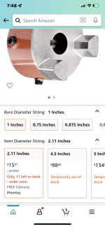

Thanks all. The set screw on the Lovejoy mounted to the engine will not come off at all I’ve twisted up two Allen wrench. Sprayed it with penetrating oil and used heat. Nothing. Any advice? Amazon sells them but I’m not sure what size I need. Thanks.

Predator is 3/4" shaft. I think the second is the diamater of the coupler itself.
Tractor supply or other farm store carries them as well.
