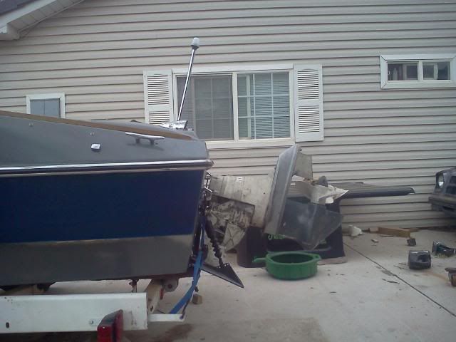

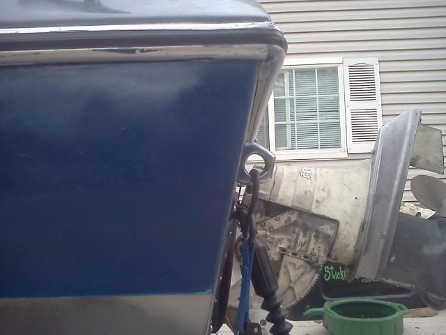

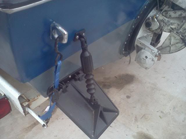

Ok I think I found one big issue. Look at my transom it is NOT straight up and down its at a STEEP angle.
I BET the tabs are TOO farin the water. I think I need to level the boat out to the ground. then set the smart tabs at the 25 deg (or whatever it is) from the GROUND not from the transom. it makes TOTAL sense. they are just WAY TO FAR in the water so they are dragging and slowing me way down.
here are a BUNCH of pics sorry they are big but I figured they might help out.

While I am Asking. see where my speedo Pitot is? right next to the right smart tab..... I wonder if that could be messing with my speedometer reading???? I don;t have a gps to check it...

Don't worry, most transoms are not straight. The angle is from the bottom of the hull. Could you pop the pins and lift the tabs and take a picture of the hull? While your bow may be trihull, the transom looks like a standard V with chines. If so, they should be mounted just inward from the chines, and parrellel to the v.

Ill pop them off and take a picture. it actually does drop back down again making it tri hull in the back.
Do I have them to far out?
and do I need to make them 23 deg from the hul not the transom.
