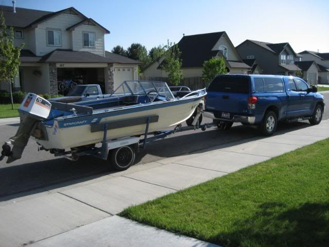

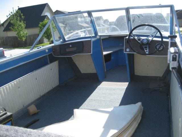

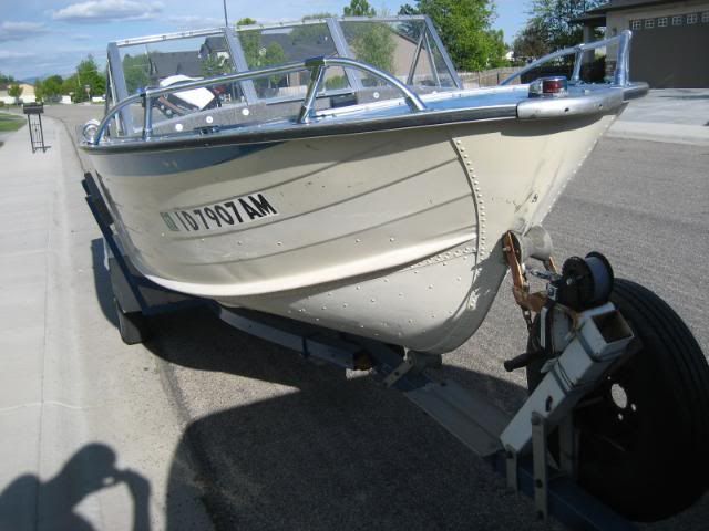

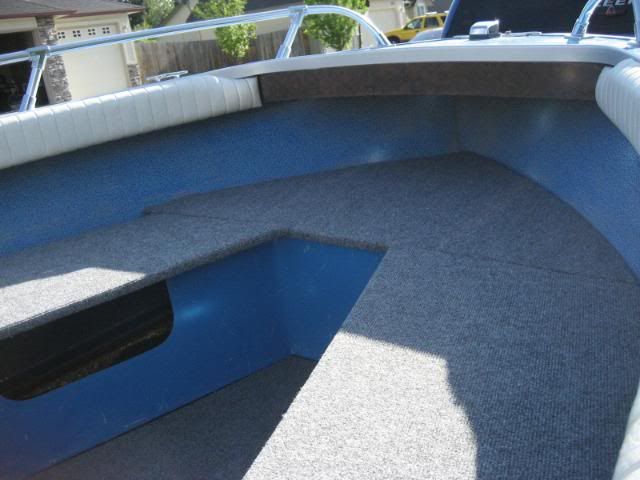

Well the glass "project" though never really started...http://forums.iboats.com/showthread.php?t=471908 is gone and I have found a 1975 16' Starcraft SS. I was supposed to pick it up on Friday but I couldn't wait. I fear that the motor will need some major work or replacement, but we will soon find out. The boat itself has a good floor and the PO has done some good and some not so good mods. Before the pitch forks appear as my screen saver and "More pics, more pics" come chanting through my computer speakers...Here they are.

Very nice.... we have the almost identical boats.

Nice SS Tundra, I'm sure you won't regret the swing over to a tinny. I really like the bow rail on it, if youesver want to put a bow mount trolling motor on, you will not have to cut it.
