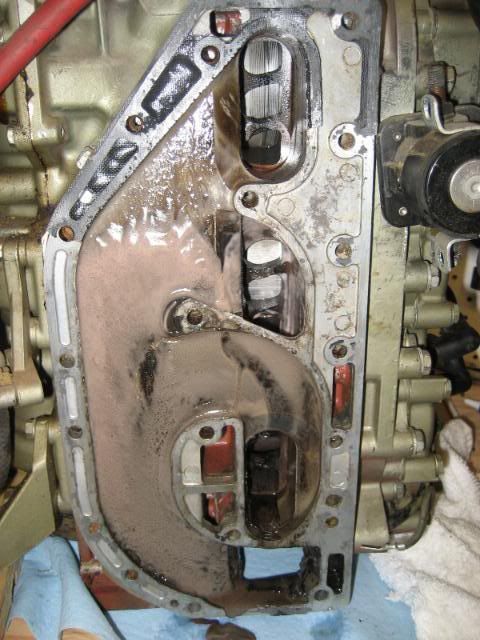

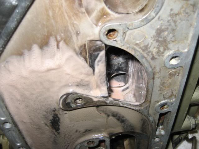

Update...Power head has been removed and the exhaust gaskets have been replaced. That is the short story...This is what I found while removing the exhaust housing...
Milky white everywhere.

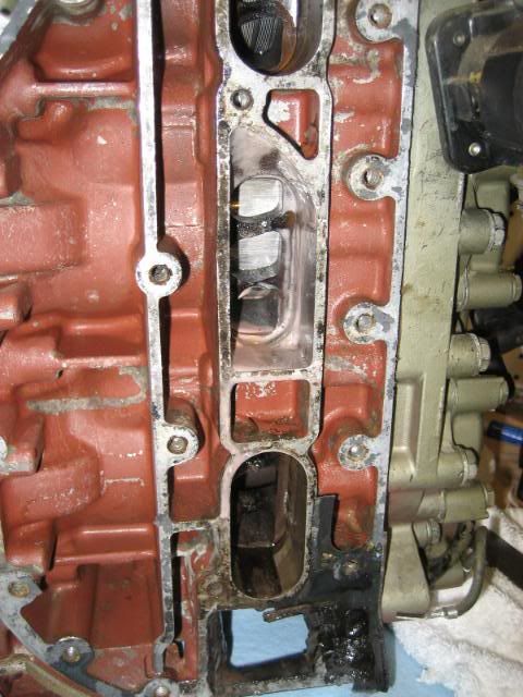

Here is what it looked like without the housing...
Upon putting it back together one of the many bolts that hold the housing to the block broke. :( I had to removed the entire housing again, and thankfully easily removed the broken bolt with vice grips. The bolt was hanging out by an 1/8 of an inch. It has been put all back together and has been torqued to spec. Next up dropping the Lower Unit. It is currently off, and has been inspected. Whom ever last took this apart did not put everything back as they should have. The seal for the exhaust was upside down, and there is a missing bolt which is supposed to be installed underneath the trim tab. The Lower Unit was dropped to try and replace the water intake screen. This screen hits the drive shaft bearing house when you try and remove it. It has stalled here for the time being. I have another post in the Johnson forum on this. http://forums.iboats.com/showthread.php?t=486032

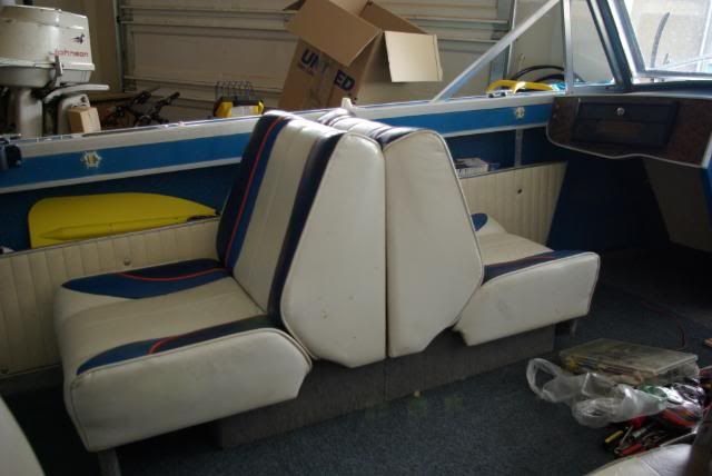

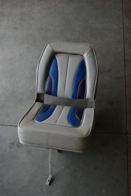

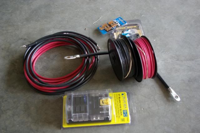

Where have the day's gone? It's almost been a month and I have yet to touch the boat :(. The wiring in the boat was a mess:eek:, and most of it did not work correctly or did not work at all. Here is what I will be putting in the boat today.
There is a missing fuse at the battery, and a couple of interior led lights that I am waiting for as well. I also picked up a couple of seats. One back to back and one pedestal seat. I think I will be mounting the pedestal seat on a plywood box that I will build. I see that I have captured a pic of my 1961 Johnson 5.5hp for the '61 Starcraft Starlite 12 I have in the back yard.

Glad you got the O/B running fairly well and had a chance to run the SS some. Liking the idea of a back to back lounge seat for the crew and a pedestal helm seat. Gives you a bit more cockpit room. Why do POs make a mess of wiring? Every boat I've looked at had spaghetti wiring. Miss the glasser?

Great layout with the seats. You can fit a nice cooler behind the drivers seat for stuff like lunch and beverages. Still having idle problems? Sounds like you are going to tear into those carbs again. If you are in there, make sure the passages are clear as that can mess with your idle.

Thanks. I wanted a little more room for fishing or just storing a supplies. I don't look forward to tearing into them again...It would be the third time :(. I have a few things I am going to test whether choking or increasing throttle helps. I didn't spend much time working on this problem.
I took me all day to get the wiring almost done. I still have a couple more things left with the wiring to finish up. Then I need to make a box for the captains chair and mount the back to back seats.

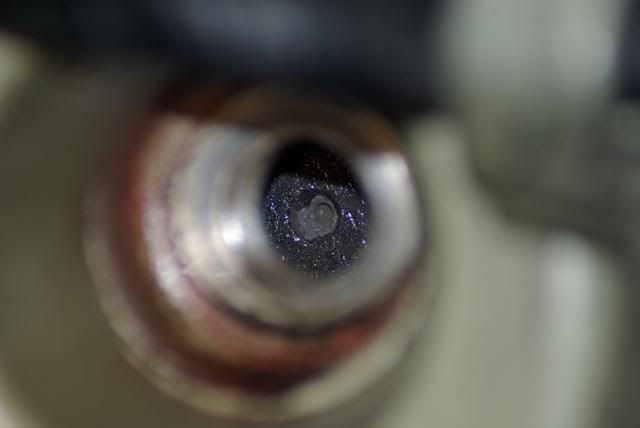

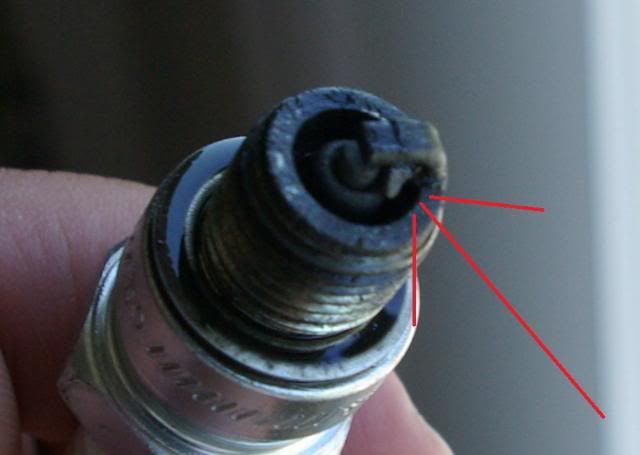

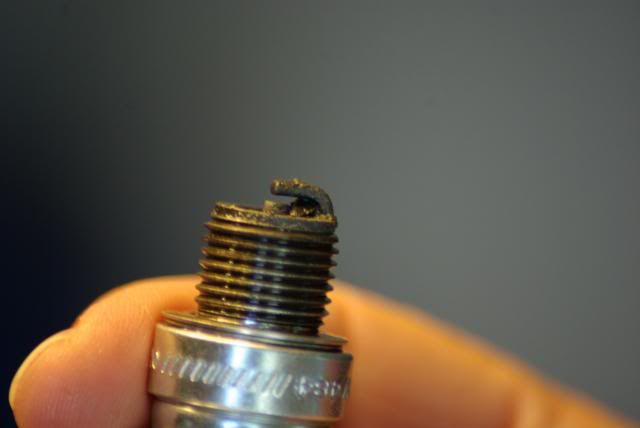

Seems like forever since I have had a chance to hit the lake...Took the boat out yesterday, and well things started well and ended fast. Fifteen minutes into the trip engine shut down like it had when the power pack went out. I was thinking that the power pack that had just been installed went bad or one of the coils had gone out. Engine would start and idle but die when going shifting forward. (My thinking is it was running on two cylinders but did not have all the tools to diagnose further. Paddled to help and got towed to the dock. After arriving home I put it on the hose and tested spark. Spark test ok on all three cylinders. Pulled the plugs and this is what I saw on the plug and then what I saw when looking in the plug hole on the middle cylinder :eek:
Pitson has a nice hole in it :(. Not sure what could have happened, looks like it may have been running lean on this cylinder for some reason. Looked good after the previous trip out. I guess I'm in the market for a new engine. Thinking Johnson/Evinrude 85 Late '77-'79 or newer if the price/condition is right.

Ya know Tundra... it also almost looks like the piston hit the top of the plug....like was a plug too long installed at one point. Sorry to hear the news :( that really stinks.
From the angle that I took the photo it may appear that way, but I took the picture from the side. When you look staight on there is nothing. But you may be right as I am only an amature trying to make a go at it. Pluggs that were installed were L77JC4's which I'm pretty sure is correct. Never the less what has been done has been done.
