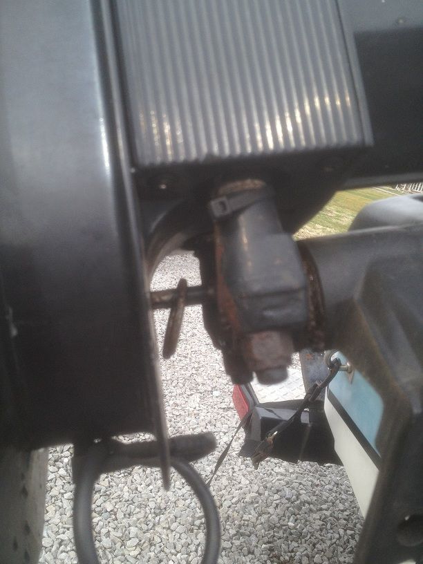

2000 mercury 90 hp saltwater, The motor moves alot due to this clip in the picture is out.Can some please explain how I can get it back in where it goes? Ive tried everything I can think of.Thanks

Is this related to your previous post where you stated play in lower motor mounts/yoke. Has any repair been done? The ring popping off is probably a result of excessive play, possible the lower splines of the swivel are gone, not allowing ring to be retained. Check with mirror and flashlight.
