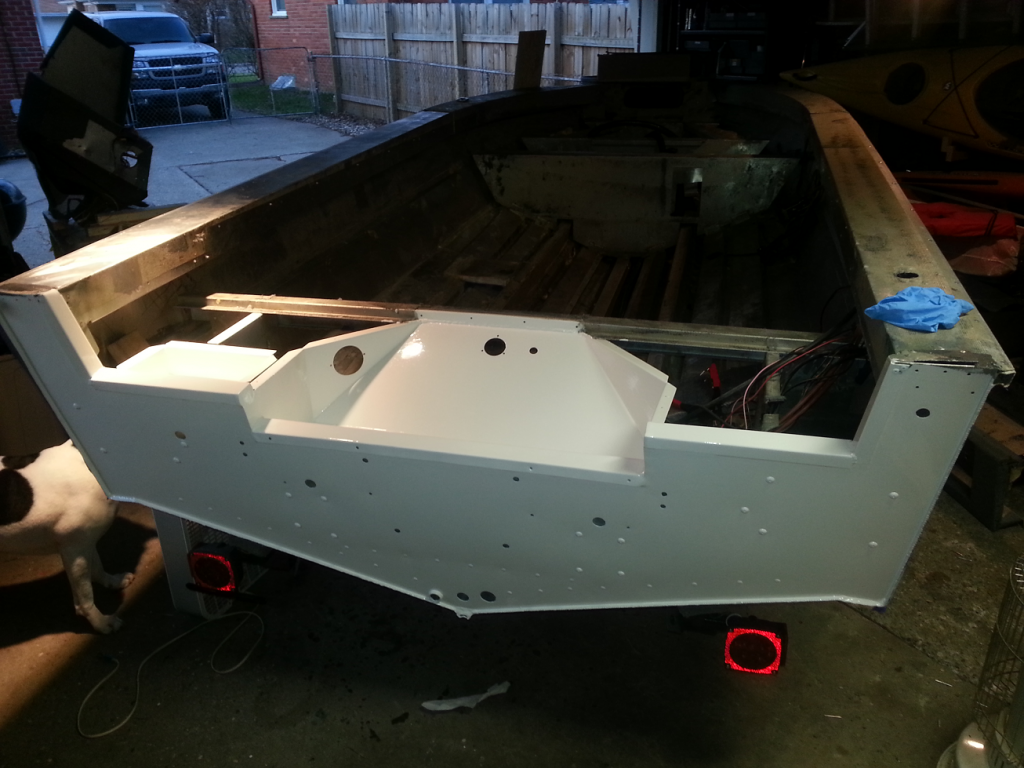

Transom is in and the splash well and cap are on. Tomorrow I plan to start prepping the back of the transom for paint along with some other odds and ends while the paint is drying.

I only have one pic of the transom installed...sorry.

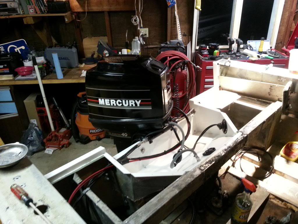

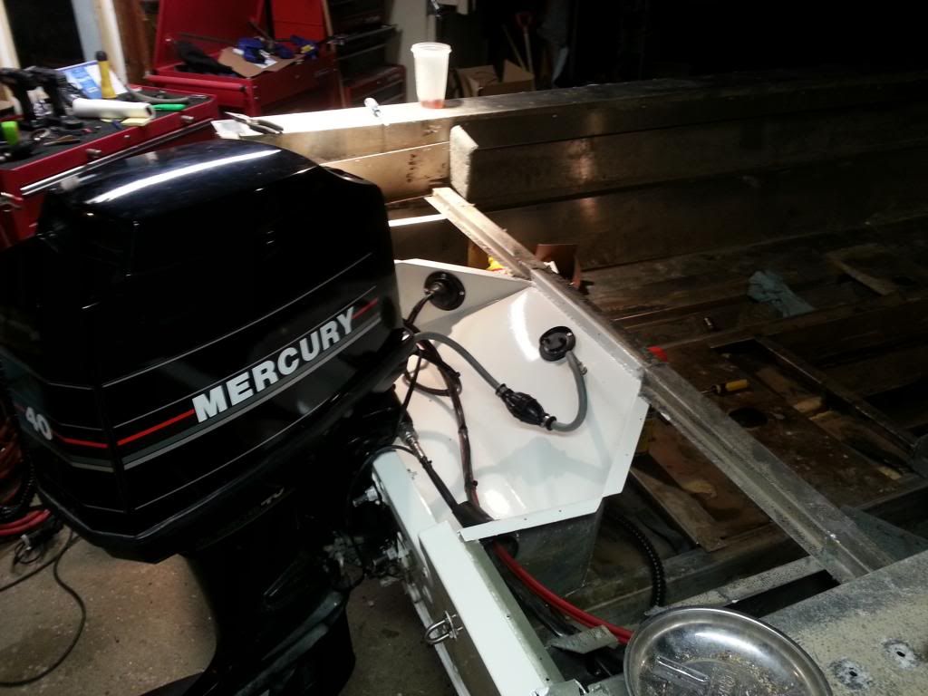

Over the weekend I was able to install the engine well and transom cap and get some paint on it. The roll and tip method was a bit tedious but it came out pretty nice. I have a few sags I will need to sand down and touch up in couple days. It would have been much easier to leave all of the transom bolts out before painting but I had already installed them with some 5200 and I didn't want to deal with that mess again!

I finished painting the transom yesterday and I installed the rest of the hardware...that 5200 is EVERYWHERE! I finished installing the engine today.

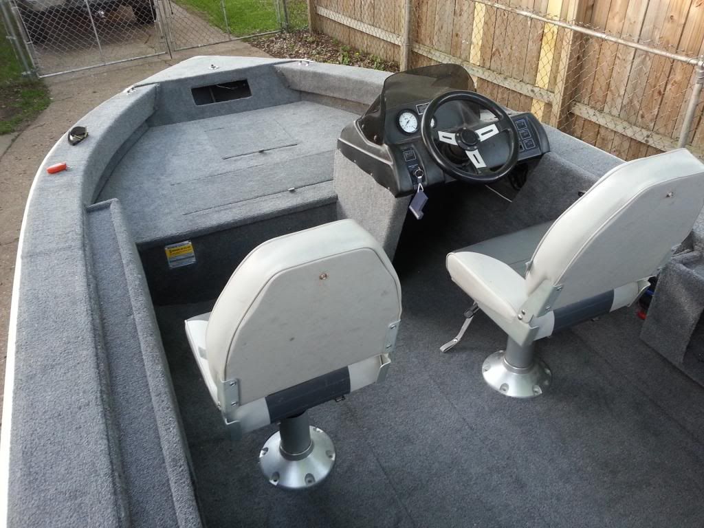

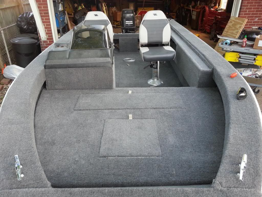

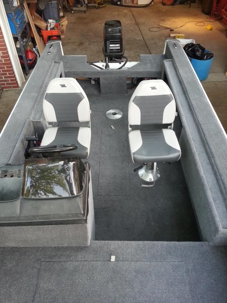

The boat is finished.....well...almost. I have the fish finder/ GPS on order and the pictures do not show the old bow mount trolling motor. Finished until I can get some fun stuff.
