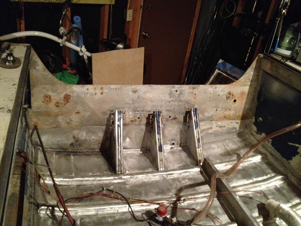

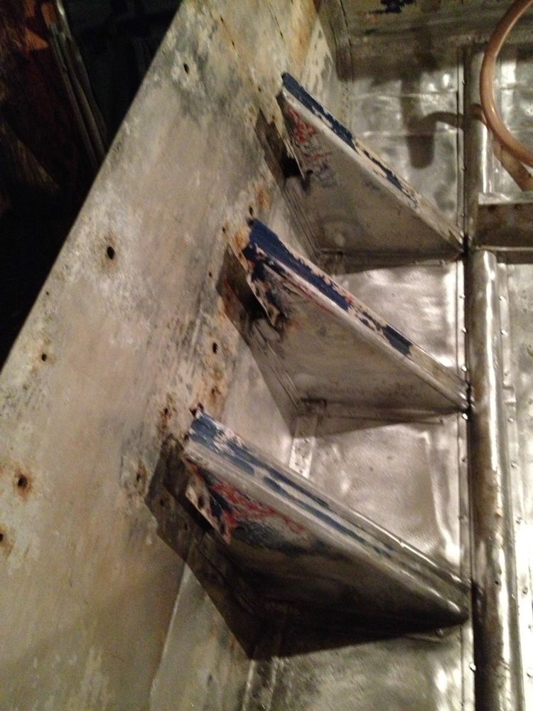

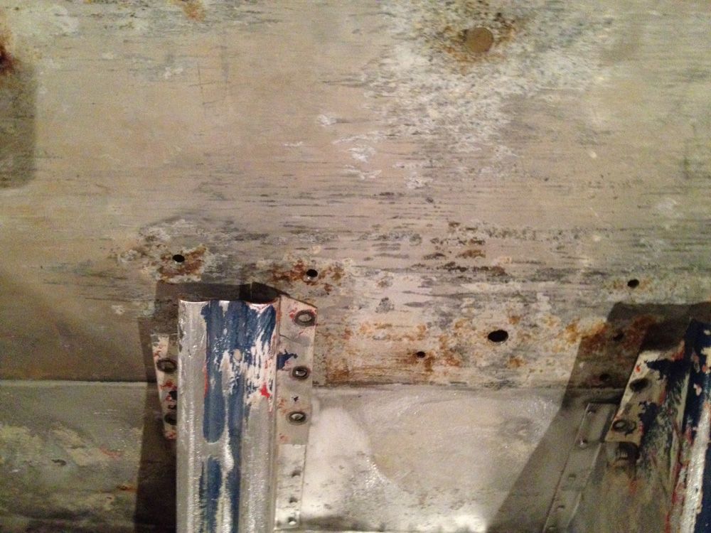

I have been making good progress on this boat. Although I have ran into a concern with the angled transom supports.
The very top of each of my angled supports for my transom are fractured. There are 6 bolts on each of the three supports and the top two bolts on all are in a fractured section. The other four bolts on each are nice and secure to the transom. See the photos. Otherwise I think the transom looks ok and I was not going to replace it. What is your expert opinion on these fractures and if I should incur the cost and time to pull the transom and fix these? Is there an easy but proper fix for this problem? Is this a common issue on old (1965 starcraft starchief) aluminum boats? Any help would be of value. Thanks.

Those angled pieces are called knee braces, and they broke for a reason. I would double check that transom again ;/
As for a fix I bet you could get away with a couple pieces of aluminum - bolt them in on the six bolts and rivet them into the knee braces? Hopefully I explained myself well enough =D

yes, that's a common problem on all old tinnies. wood transom begins to bow, usually due to rot, from weight of motor and then knee braces crack. before you decide your transom is usable "as is", pull corner caps and check for rot, poke sharp tool in near bottom of trans wood, and lay straightedge against trans top edge to check for bowing. you prolly need to replace transom altho i agree it does look decent in pix. once trans is replaced, or if you decide to use it as is, you can add reinf to the knee braces by riveting in some extruded Al angle.

Thank you for the confirmation on the hull prep. After hearing peoples thoughts on the transom and knee braces I will pull the motor and replace the transom. While I have the transom out, I will have the knee braces welded and beefed-up with extra aluminum plates. A local boat shop uses a welder that they claim has lots of experience with welding aluminum boats.
