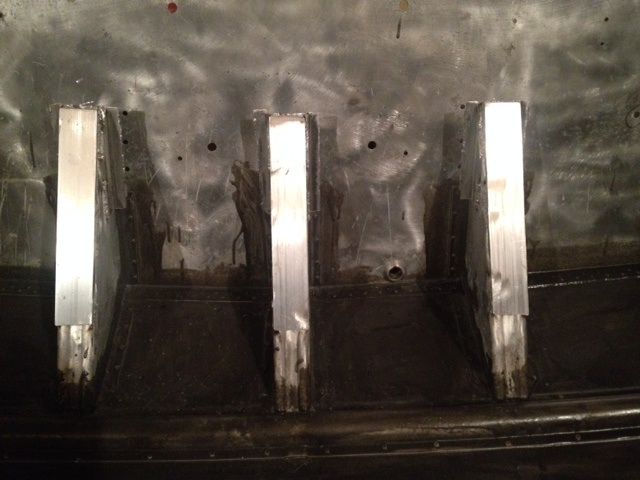

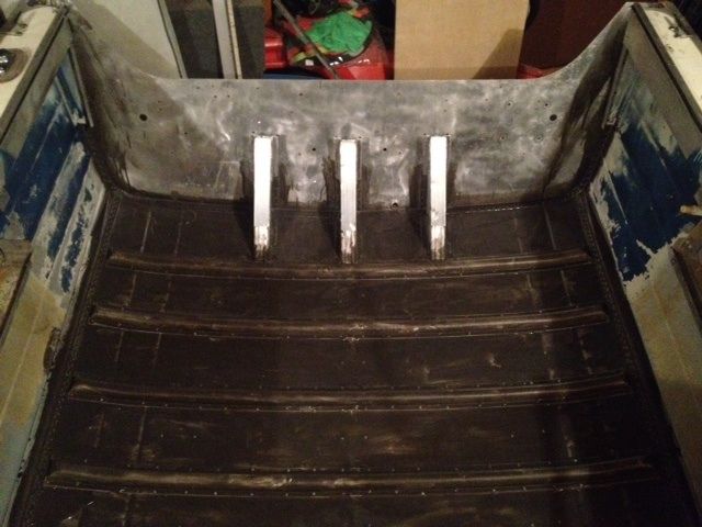

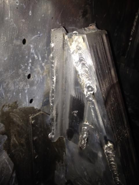

Knee brace welding done and "coat-it"epoxy of the hull done. The welding definitely beefed up the braces and fixed the stress cracks. I am very impressed with how the epoxy bonded and how robust it is...wow. Next on the list is to build a new transom and install it. Then i plan to suspend the boat (got a novel way to do this) and prep and paint the hull.
