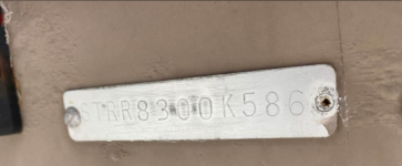

Found your sight as well as a few others that I think are going to be very helpful with my new project. I am picking up a Starcraft 1971 Model Unknown on Sunday w an HIN919886.
I plan on gutting it and rebuilding it, changing the layout a bit, repainting it and using for duck hunting and fishing the lakes and rivers around my home In Beaver, PA. This will be my first boat, and I am pretty excited about the undertaking, would like to have her ready to go by September. we will see.
Can anyone help me with identification of the model and HP rating? Attached are the only pics I have until I pick it up.
was thinking it may be or a Mariner or an SS?
sc2.jpgsc3.jpgsc4.jpgsc6.jpg Any info is appreciated!

Doesn't look like a Super Sport. Splashwell and bow rise don't look right. That being said, my SS16 is rated for 90 HP. Any pictures of your knee brace?

@Emerger its a 1971, no HIN plate to find or decode. The Ser# he posted is all there is and it doesnt really decode, not that HINs decode much anyway. Year and maker only typically.

That is a SN, not HIN, and it falls on my list as a '70, my guess is a Seafarer, either 14 or 16
or it could also be a mariner-V or Star trek-V-
BTW - I just looked at the '71 catalog, the molded "Starcraft" attached to the rear sides has a solid black background, different then the black letters of the '70 version's. It matches the '67 molding.

And the winner issssss…… 16’ Mariner Rated for 45HP87B5AB39-F297-4305-AA5C-A53EACC11F26.jpeg
