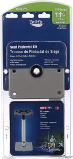

As for the seat mounts/pedestals, are those rated for movement or only stationary/under 5 mph?
SHSU
Im not sure on those pedestal ratings, really the plan is they will be stowed or unoccupied until we hunt or fish. They are this same model i believe.
I also have this seat Base I can paint and reuse with a more appropriate seat.
My buddys dad is an aluminum welder and i used to work for him back in the day when i was in college , he came out and checked the project out on sunday and is going to weld me up a rear transom box/storage bench/ seat/ elevated pedestal base for fishing. we are using these 2 pics as a reference right now. This would also double as i seating are for 2 passengers getting to the spot.
I want to put the console back roughly where it is, have a raised deck, lower than what i removed from front of console to bow with a latch for storage. have a removable pedestal on front deck, middlish of boat close to transom box, and one on top in middle of transom box. So i would have 3 bases w removable seats, seating for 2 on the transom box, and i would be able to drive/hunt from my chair

I used t-nuts under the deck on my Kingfisher but ran into a problem. I didn't put a backing plate over the t-nuts to fully keep them in place, just glued them down.
When I installed the seats, long after the deck was fully installed, I knocked a couple of the t-nuts loose and they went down into the foam under the deck. A major pain. :cautious:
After much research and time, plus some more expense, I found a solution that took care of the problem. Had I simply installed a backing plate, the issue wouldn't have arisen. :rolleyes:
