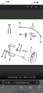

Can anyone help me out?
I am in the wiring phase right now, and the rear of the motor is missing a bolt. I was using the schematic for a 2000 johnson J50PLSIF, as i can’t find anything for my specific model, Johnson 2000 50HP Long Shaft, Model J50VLSIG S/N: G04880135. I used this schematic and was emailing with Crowley and we thought it was bolt 40 part 0322323, but it isn’t, that bolts a good bit too long.
I’ve included 2 pics of the missing bolt area

Best thought I have for that one is ask the question in the johnson/evinrude forum section. Probably someone with knowledge or ownership of that exact model motor that would know more. Thats strange its missing one random bolt though.

Looking at it, it almost looks like its to bolt something on to the engine, not to hold the head to the engine. The head takes 10 bolts per Crowley. So as long as you have your 10, I would guess its for an accessory.

You are correct. I took the advice and posted in the Johnson/Evinrude forums and those guys got back to me right away. It is for piece number 10 which is an Optional temp gauge, mine has an alarm. So I’m good to go.
