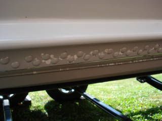

Starcraft Islander 2007 (Aluminum Boat). The paint around the rivits is popping below the water line. Starcraft says it is electrolysis & no warranty. Are there any ways to treat this problem. Any input is greatly appreciated. Thx much...silvrfoxm :mad:mad:

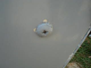

The pictures are not detailed enough, in my opinion, to make a determination. I am inclined to agree with electrolysis-for now.
A close examination would show signs of pitting in the metal, a sure sign of electrolysis.
If there is no pitting and only the paint top coat flaked off, then there is another issue.

It doesn't seem like the paint bubbled up as I didn't see any bubbles anywhere. I didn't know of the problem until the boat was taken out of the water for the winter in mid October. The marina cleaned the bottom for me & that is how I found out about the problem. The paint looks good on the smooth bottom, no popping or peeling. It is only popping at the rivits under the water line. Thx for any help in advance. silvrfoxm.

If the primer is not "popped" it is not electrolysis. You may also have rivets along the keel, how do they look?
I would ask (nicely) Starcraft to explain how it can be electrolysis if the primer is still intact.

In refernce to post#17. Some of the rivets on the smoothe part of the bottom are popping. The rivets on the keel aren't popping, but there is some corrosion around a few that looks like dried plaster that can be scraped off with your fingernail. The boat had been cleaned by the marina & I don't how much corrosion was there before the cleaning.

It would be very interesting and informative to get a look at the back (inside) of several of the rivets that seem to be affected.
If it is electrolysis, it may affect both sides. For electrolysis to take place, you need a medium. In this case, it is water. When you get a chance, take a look at some of the rivets in the bilge. Especially those at the bottom of the transom. Those probably would have had water on both sides (inside and out).
