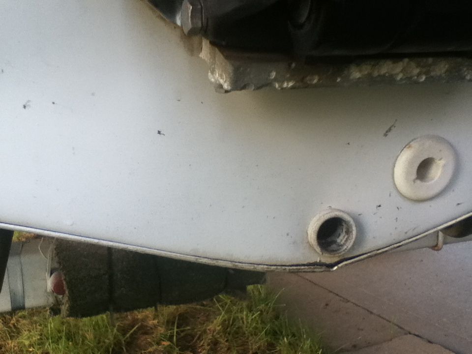

My dad got re-ended pulling his boat home from the lake a couple days ago. 1988 18' StarCraft SFM. He was sitting at the stop light and a girl (probably texting) ran into him. He finally got everything running perfect and ran down to the lake to test it before a planned fishing trip to the river.
Visible Damage-
-bent the prop
-broke some of the lower unit housing off and the skag (cosmetic)
-mangled the 'arm' of the trailer that the bow rests against and holds the winch
-bent in the transom area between the rear transom braces, don't think it broke the transom wood, but the channel supporting it pretty good is definitely bent
-you can also see ripples in the side of the boat at the rivets, from what I assume happened as the force was transferred through the hull to the tongue of the trailer.
It will be interesting to see what the insurance adjuster will do. The hull isn't wrecked, but isn't completely repairable either, and certainly wouldn't be worth hiring a shop to fix. Also hard to guess what the impact did to the internal of the motor. The motor was just rebuilt and doesn't have 10hrs on it yet.

If the hull isn't completely repairable ( and if the sides are bowed I doubt it is ) then the boat should be totaled. I doubt there was any serious damage to the motor itself but the motor mounts should be inspected.
that lower unit should be replaced. ( or at the very least, that skag welded back on and the unit taken apart and inspected internally )
Also, It appears from the picture that the lower unit housing is cracked...

I don't think the hull is scrap if someone wanted to fix the transom. The sides aren't bowed or anything major that I can tell, but they apparently did flex pretty good and it could never be fixed to preaccident condition. The ladies insurance will cover it, but I'm guessing it will be a fight and they will try and total it for less than it is replaceable for.
Oh, and he said the hyd. tilt leaks down now. :( This was going to be the motor I was going to get and put on my 16ft I'm fixing up.

Hydraulics took a huge hit for sure.
Probably bent the prop shaft enough that it will not run true.

Thing is that the powerhead is almost new. If I'm patient I could probably find deals on a lower unit if this one is shelled. I am hoping that it is just the seals in the hyd unit and they aren't to terribly difficult to repair. 90HP 90's Merc in good shape aren't cheap from what I've seen.
