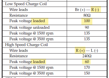

A the manual calls for the low speed coil test Red and brown 60 dc volts and high speed coil test red and blue 100 dc volt ..
CDI Troubleshooting guide calls for low speed coil test Red and brown 100 dc volts and high speed coil test red and blue 60 dc volts. I spoke to cdi and they said the low speed coil always has a a higher voltage then the high speed coil. so that is the specs I'm going with.
with that said if I test the low speed coil test Red and brown using red to red test lead and brown to black test lead I get 26 volts but if I test brown to red test lead and red to black test lead i get 60.
No where does it state which leads to test with I would assume red to red and brown to black which gives me 26 volts connected. but if I do the same test unconnected 78 volts
Moving on to high speed side It calls testing red to blue for 60 volts and I'm getting 125 volts connected or disconnected using red to red test lead and blue to black test lead
But if I use red to black test lead and blue to red test lead I get 13 I am kind of confused at which lead gets used on which wire. Maybe since red is the common wire it is a ground ? so it should be tested black test lead to red wire..

there are three wires for the stator Red Blue and Brown.. The black that I am speaking off is from the meter... which test lead goes where ? If I test red test lead to blue stator wire and black test lead to red stator wire the output I get is 13 dc volts. But if I switch it around and test black test lead to blue stator wire and red test lead to to red stator wire I get 60 dc volts
dingbat
Nov 20, 2001
17,385
Normally the color of the lead would simply reverse the polarity, -60V instead of +60 volts
In this case, polarity matters since your only rectifying half the wave cycle to test.
Keep black lead on red

Have you already tested the CDI box output and found that it is below specifications?
Follow this and see if it makes a difference.

@boscoe99 What manual is this from ? This is all my manual says 1773189078127.png
So this is opposite of what I was thinking but if I follow this and I test Brown stator wire to + test lead and Red stator wire to - test lead I get 60 volts which is not within specs for the low speed. And if I test Red stator wire to + test lead with blue stator wire to - test lead I get 120 which is well above spec. I am getting 105 volts on all primary wires coming from the CDI.
