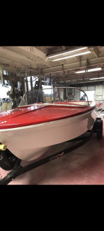

Hey guys new member here. I'm in the process of bringing life back into a 1964 Pacific mariner scimitar. On the back hangs a 1959 Evinrude lark 35, the 50th edition golden jubilee. This boat has a mercury quicksilver ride guide steering setup, and all I'm missing is a way to connect from the cable to the outboard. I've looked at several options and bracket kits, but I'm unsure what to get and I'm hoping you guys could steer me in the right direction. Thanks!

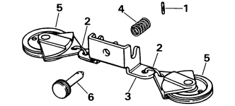

Searching thru my old OMC catalogs, I can only find Connectors for the Pulley-Clothesline Systems. I have actually only ever seen the P-C systems used on those engine.

Yeah that's all I've come across as well, but what is interesting is there is no holes for a cable on the port side motorwell. so its as if this boat originally came with the push pull cable type steering. I'm not against changing out the steering system as long as I can retain an older steering wheel. Any recommendations on what I should look for?
Some more pics of the boat. The red one has been in my family since new, and is currently under going a complete restoration, also a Pacific mariner.

The original quick-style connection to the motor was a push rod+spring with a pin. You push it thru the hole in the center bar of the engine, against the spring and turn it to lock.
In your case get some kind of L bracket and drill and bolt to the engine and the steering cable. likely a 3/8" bolt + nylon locknut is close in size to what will fill the hole. I think it will pivot sufficiently to allow full steering. If not you need an L bracket with a longer length to allow the cable to be farther away from the engine mounting point.

I had cable and pully-style steering, so I do not know exactly what you need.
This is what I had for my Johnson engine.
Something like this would probably work.
