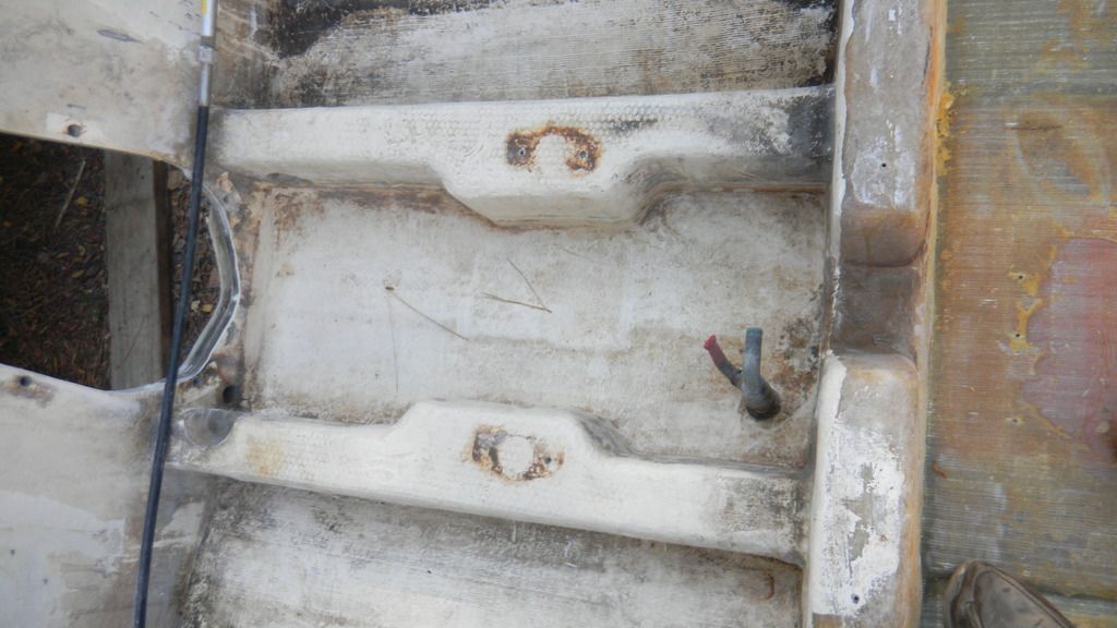

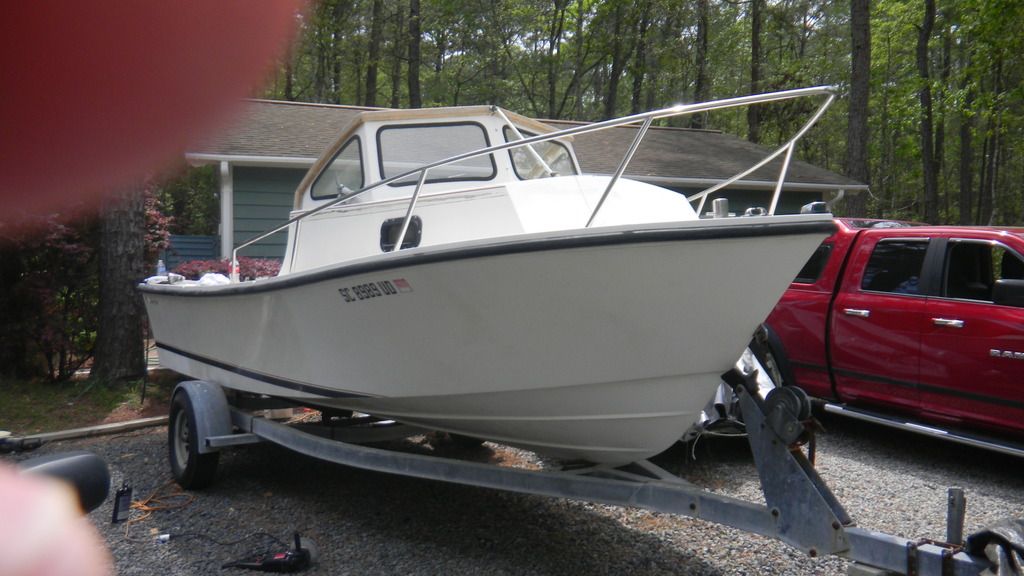

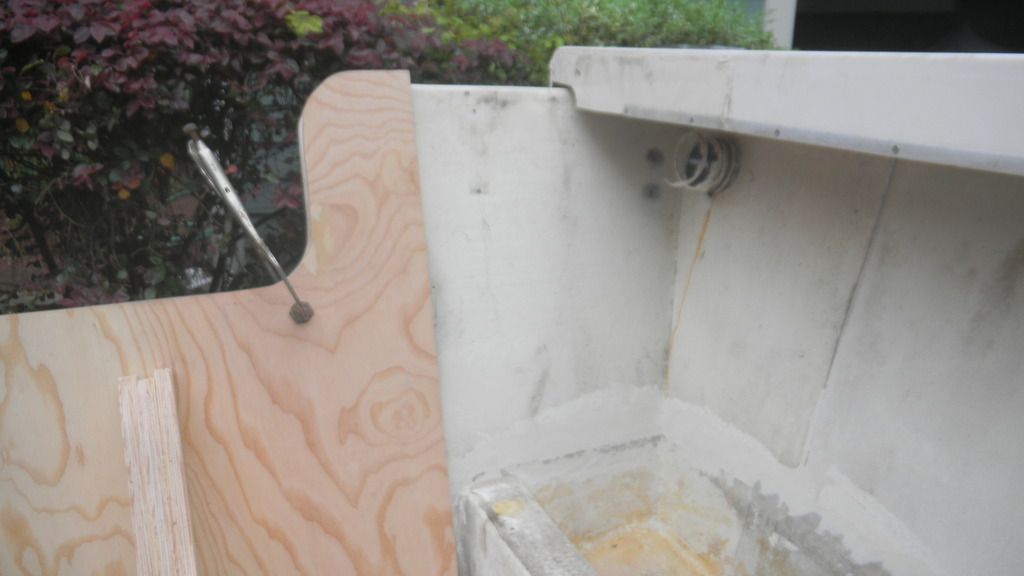

Well into the final stretch of the rebuild. Ordered the 200 Yamaha today hope to have it on the boat some time next week. Picked up a Lowrance CHIRP 9 and will be installing that tomorrow jus. Last thing on the list is install new bunk boards on the trailer and install some keel rollers that it never had. Single axel trailer with what appears to be the original tires 8 ply 2450lb load rating will probably have to replace as they have a lot of cracks in the the side walls real shame as there is virtually no tread wear, may use for awhile as the boat ramp is only a mile away. Would love to have a dual axel aluminum trailer but rebuild costs exceeded my estimates so it will have to wait
Will be posting up dated pictures

No Title
More pics

Very very long over due update the boat has been completed and in use have a 200 Yamaha on it. Boats has been fished 30 mile off shore no problems. Added a new twin axel trailer and front deck hatch for cabin ventilation.
