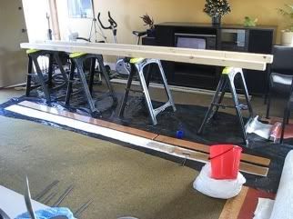

Stringer sandwiches...
Same as the transom, i wet out the bonding sides of the pieces, left for hour or two, re wet out, rolloed out glass layer(top left pic, on the floor), grip clamped the pieces together,
set it up on the saw horses in a sheat of waxed paper to catch resin drips and prevent the stringer wood bonding to anything you dont want it to, like the 4 straight long pieces of pine, (two each side) I clamped it all together as a sandwich. The planks of wood set the stringer straight and they absorb the dents that the clamps make when you clamp them up tight! to sqeeze any excess resin out of the fibre glass layer.
