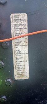

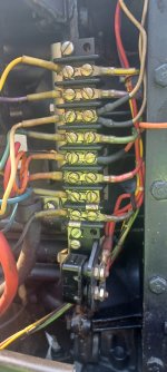

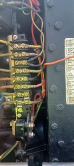

The blue wire from the other M terminal at keyswitch should go back to the terminal strip at the engine and be connected at the second screw from bottom.
There should be a metal jumper between the second screw and the first screw from bottom at the strip and the first screw is for mounting the terminal strip to the block, soo it is ground.
If the jumper is gone connect the blue wire to first screw or make a jumper from a wire and connect between first and second screw.

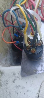

The blue wire at the terminal strip is grounded as you described. At the back of the igntition switch, the blue wire is grounded when the key is in both the off position and on position. The white wire at the ignition switch is grounded when the key is in the off position but not the on position. When cranking the motor, the white wire is grounded, and I believe that is the issue as to why it won't start with that wire hooked up

At the back of the ignition switch, I moved the blue and white wires to each other's terminal, thinking that could be a different position of contact when starting but the results were the same. I greatly appreciate your help

The issue is that you have the black wire connected at the I terminal at the keyswitch.
Remove it and isolate it at the terminal pad.
No ground (minus) wire should be at the keyswitch.
Use it if you will have auxillaries at the remote control or the dashboard.

Yes sir, that was the problem! I deeply appreciate your help. Thank you so much for taking the time to help me. I will pay it forward.
