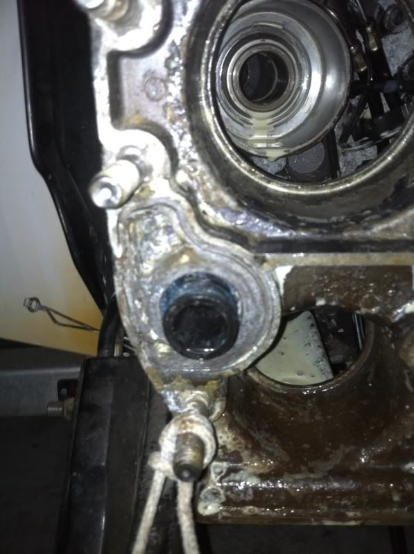

. . . And so the problems continue. I pulled the lower unit off and found two things:
It looks like there is a small hole on the bottom of the unit which I found out is actually a bleeder hole to drain water. I was able to clean it out to fuction properly. The other problem is that the outside casing around where the seal goes for the water inlet is missing. It looks like someone might have used a screw driver to pry the unit from the transom and broke a slight bit off. It doesn't effect the groove for the ring but it does have metal missing. Maybe I can reform it or seal it.
On the good side, there was plenty of grease still inside (water mixed) without any damage to the U-Joint. It doesn't have any play at all. That's good for parts but not the answer to my misfire. Since water has gotten into the u-joint boot, other than the basic replacements of water seal, o-rings, gasket, and shift cable grommets? Should I pack new grease into the bearing just inside of the opening (shown in the picture)?

What does your gear oil look like? That looks like emulsified gear oil all over the place.

I'm going to check it out today. Yeah, there was quite a bit of grease/oil/water that leaked out of the ujoint bellow boot. It was white/green in color. You can see it in the top picture in the bottom hole. From the amount of oil that came out, I'm betting the yoke seal (or yoke itself) is bad. I'll check it today. This boat is starting to not look like the deal I thought it was going to be when I bought it. . . And I still have to figure out the backfire!!!

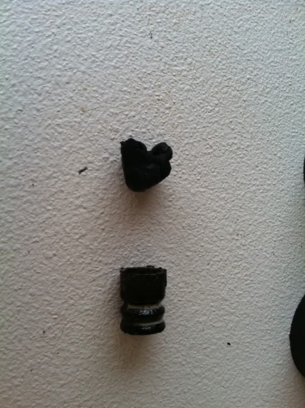

I can't seem to be able to find the shift cable grommets anywhere.
Which outdrive do you have? Not sure what you mean by shift cable grommets.

It says omc cobra outdrive but the book lists all my parts out of Volvo sx. They are two small grommets that goes into the housing around the cable. Mine is the version that has the tube going through the back of the boat so it doesn't have the large cable boot like in the rebuild kits. They are about the size of the rubber caps on a brake caliper protecting the bleeder. Here is a pic of the damaged ones:

Those aren't drive parts, they come with the cable. Not sure you can even buy them separate. You might check with your local boat shop, I know when I replaced cables I saved the old ones if in good shape, and used them quite often on cables that were missing them.

Thanks for the info Don. I'll have to check out Marine West or similiar for them. At least I have my old ones to take with me (or what's left of them).
