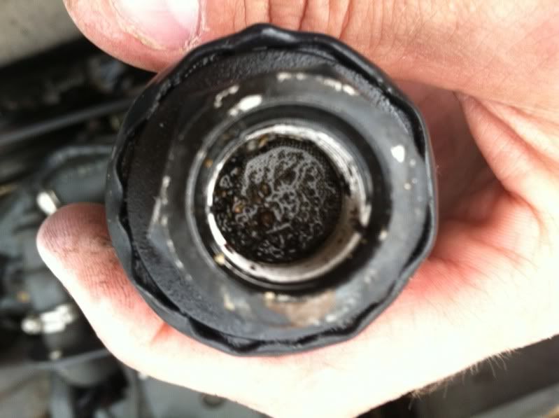

Re: strange knocking noise above 2,000 rpm (5.0 efi 95')
Don, good call on the debris call in my other thread! The new pump started whining after I installed it so I took it back off and found new debris in the new pump. I took the cap off the vst and sure enough there was quite a bit of debris in the bottom. I removed the pump and pressure blew the vst and the lines coming/going into it. They are clear. I checked my water/fuel separater and there was some black debris in it as well. Maybe the tank is collecting debris? What do you think? Also, when I had the lines off of the vst, I ran the low pressure pump and filled the vst up about half way to check the fuel quality. There wasn't any paint or debris in it. Should I still remove the low pressure pump again? I appreciate the help. I actually might get this solved in time for some spring fishing!
Sounds like you need to clean the tank and start replacing filters more often and checking them to make sure they are clean before you damage more pumps.
