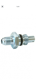

Hydraulic saginaw steering pump
picked up the flow valve for steering pumping to reduce flow
the AN6 fitting is added
took a photo comparing the original GM Saginaw powerflow valve which is 4mm ID and flows approx. 4 gallons/min and the new aeroflow powerflow valve AF 64-2915
which is approx. 2.5mm ID as managed to get welding rod down the hole, so perhaps the actual hole is 2.6mm ID and is suppose to flow 2 gallons/min
